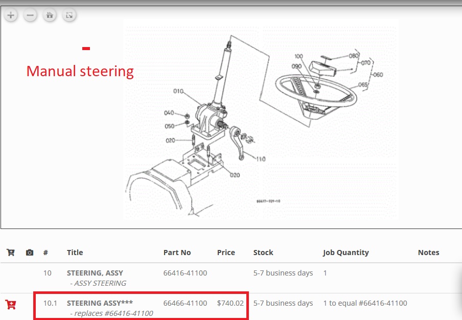

Steering shaft nut at bottom broke, bearings and tube is rusted out.
Need new shaft, screw nut, bearings, tube and the bearings that go in the column and the bottom of the box.
Could someone please tell me the part number for a whole kit for the B1750?
Always appreciate you all's help.
Orange Blossom Special
B7100 and ZD21
Apr 20, 2020
Amherst, Ohio
It is manual steering, hydrostatic, and I would just like part numbers for steering shaft and bearings and screw nut. My shaft measures 19" long.
I just want to rebuild it.

Like many things, the parts cost more than the complete assembly.
The ball nut costs more than the complete steering box which is $740.
COMP BALLNUT * - replaces #66416-41200 H6640-41200 $834.13
