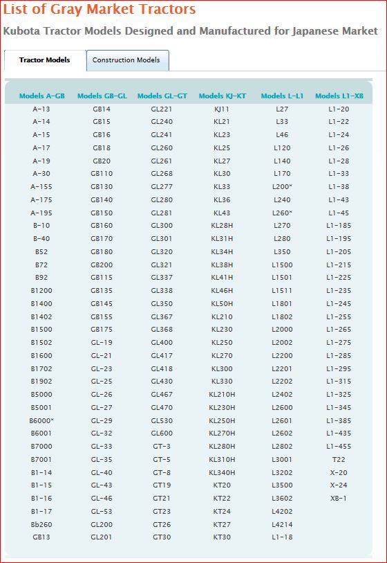

First, Only the grey/gray market Kubota's are in Japanese, Most non grey's are in English others are in French / and possibly other languages.
Second are you sure it's 4wd model as some were only 2wd.
I can't tell you the right lever or position, but if you lift one tire off the ground (not both), and with tractor off and in gear, and by hand you will be able to spin the front tire in 2wd and not in 4wd. ;)

Can you tell me what the grey market exactly is? It is imported not with an official dealer or something?

Thanks a lot. Can you see if i have a gray one?
You can see him on my instagram profile one of the last photos.
instagram.com/thomastobe
edit; I am from the Netherlands so maybe they import my Kubota from Japan. The company where I can bring my Kubota is not a official dealer or something so if there is something they have to repair, i think it is possible without any problems.

I just called the company that I would go to when my Kubota needs fixing or maintenance. I told them about my gray market Kubota and they said here in the Netherlands there are more Japanese kubotas than other.
So that 'problem' is solved. I can bring my Kubota to them with trust.
