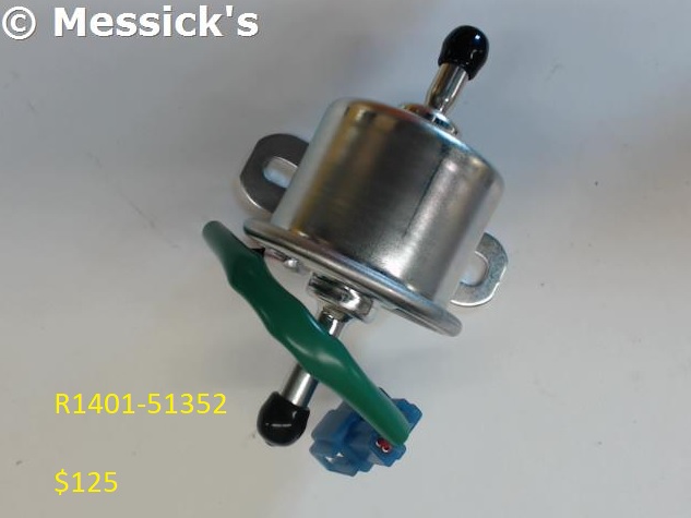

Sounds to me like you have some blockage in the tank pickup or possibly a failing fuel pump. Those are cheap and easy to replace. Stanwood sand gets in everything....lol

On that model, It's most likely a failing fuel pump. :(

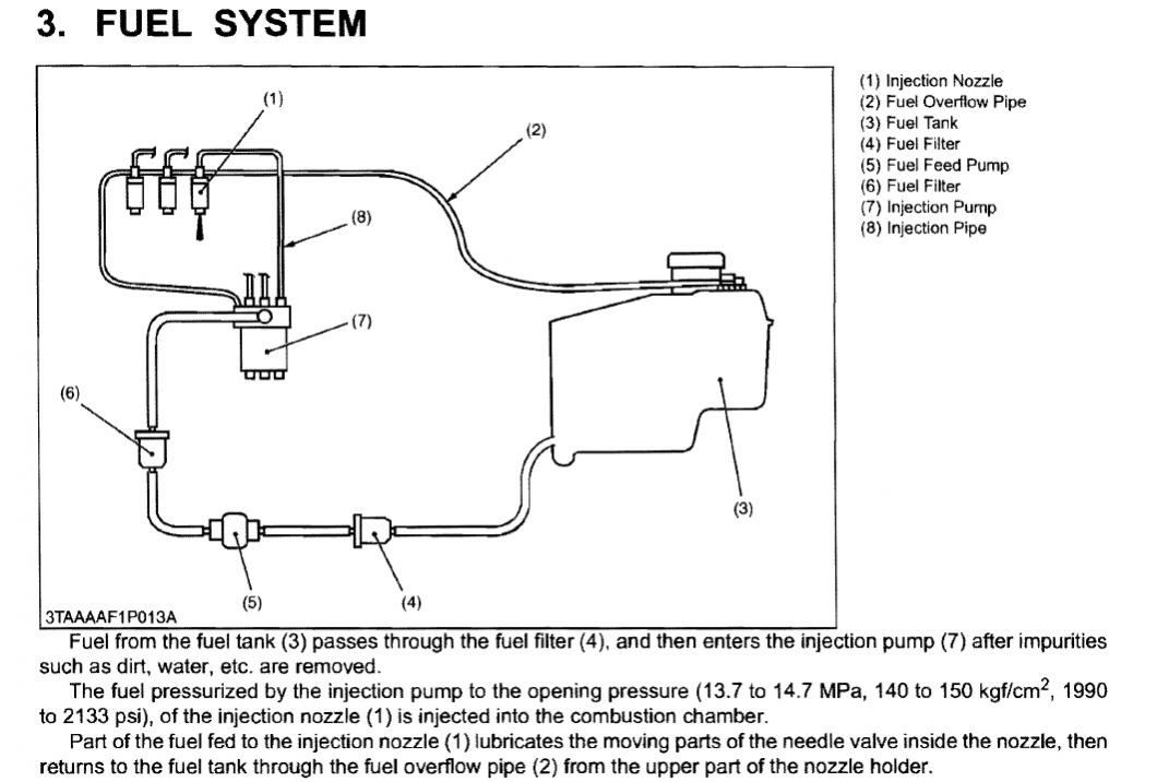

Does that model have 2 fuel filters?
I've heard of some models where they were only ever changing one filter and having issues.

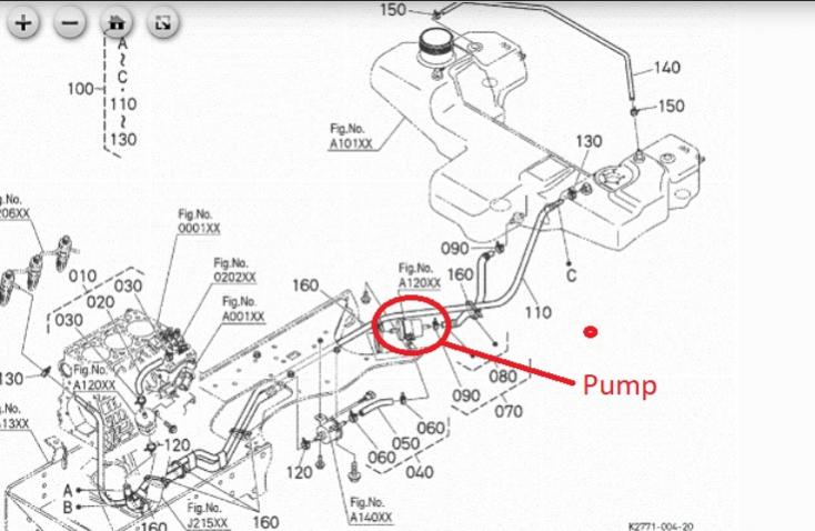

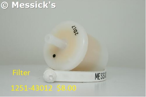

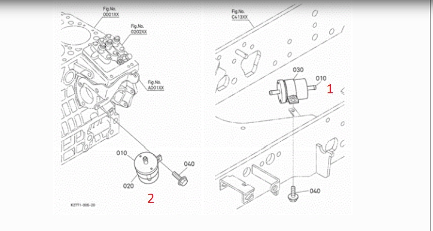

There are 2 fuel filters on the BX25.
1 is under the deck, inline with the fuel pump.
The other filter is on left side of engine. Just above the oil filter.

A second look at the parts diagram shows what is called a BAND filter.
The WSM also shows a second filter. NIW was correct some time ago :)
