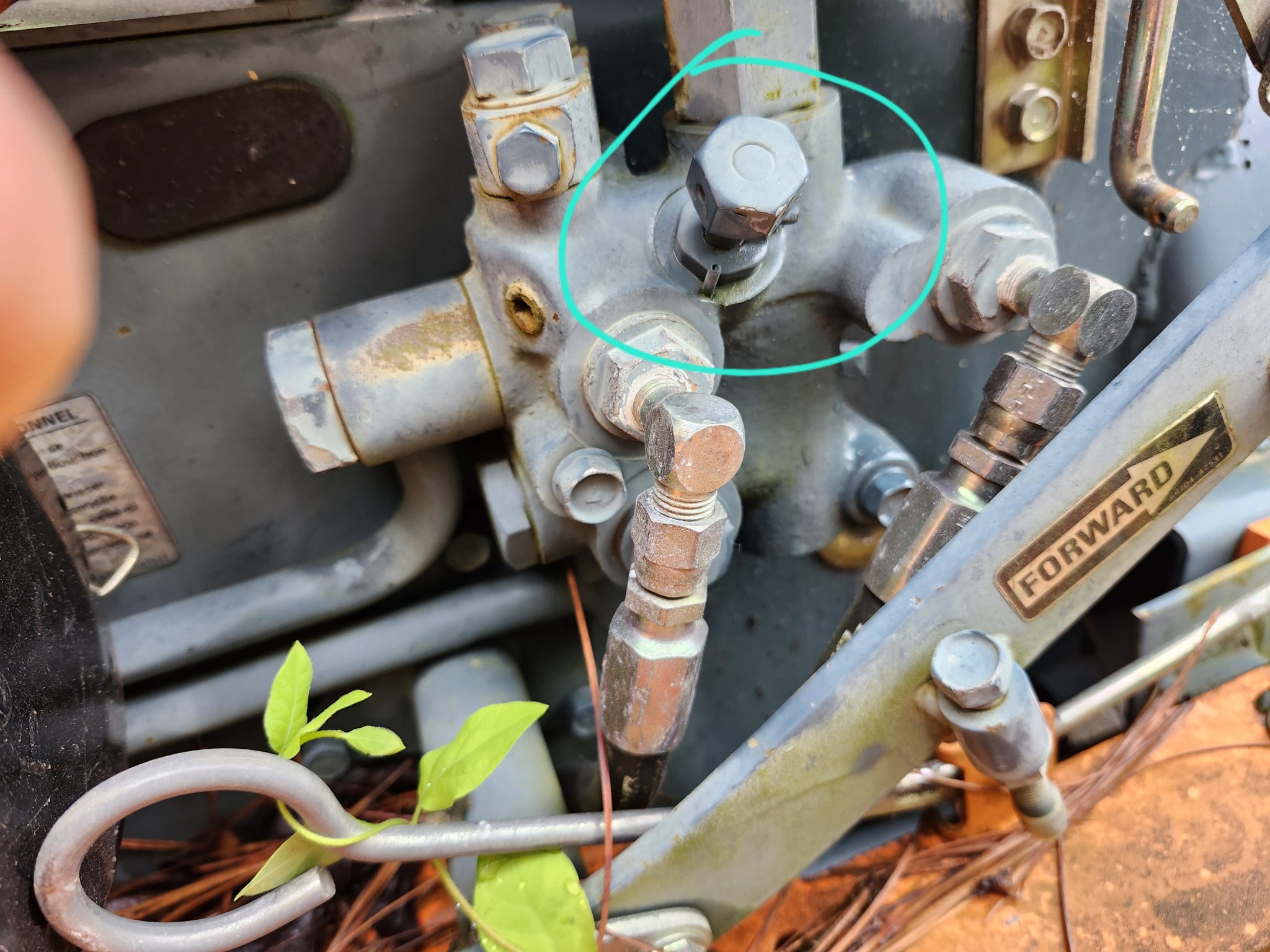

Like @D2Cat said check the valve on the hydraulic block down by your foot. Closed the 3 point should work but not loader. Open they both should work as your feeding the loader and then the loader is feeding thr 3 point but sometimes a middle position can cause problems. Also when checking make sure the stem is turning. Somwtimes the knob turns but not the stem

Like @D2Cat said check the valve on the hydraulic block down by your foot. Closed the 3 point should work but not loader. Open they both should work as your feeding the loader and then the loader is feeding thr 3 point but sometimes a middle position can cause problems. Also when checking make sure the stem is turning. Somwtimes the knob turns but not the stem View attachment 153978
Yes I have seen the valve and moved it in both positions, does not seem to make any sort of difference

Then you should verify that the stem is actually rotating when you rotate the hex.

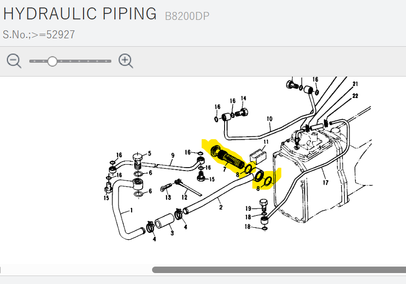

Thank you I will try this, Is there a filter screen somewhere on the machine I looked for a spin on hydraulic filter and couldn’t find one anywhere.
5,939
1,733
And you will loose all the fluid (when taking the screen out) unless you drain it into clean containers and then reuse it.
If I was doing this I would probably just buy a new screen (#7) unless it is very expensive but for sure I would replace the sealing washers (#8 quantity of 2) when doing the service.
