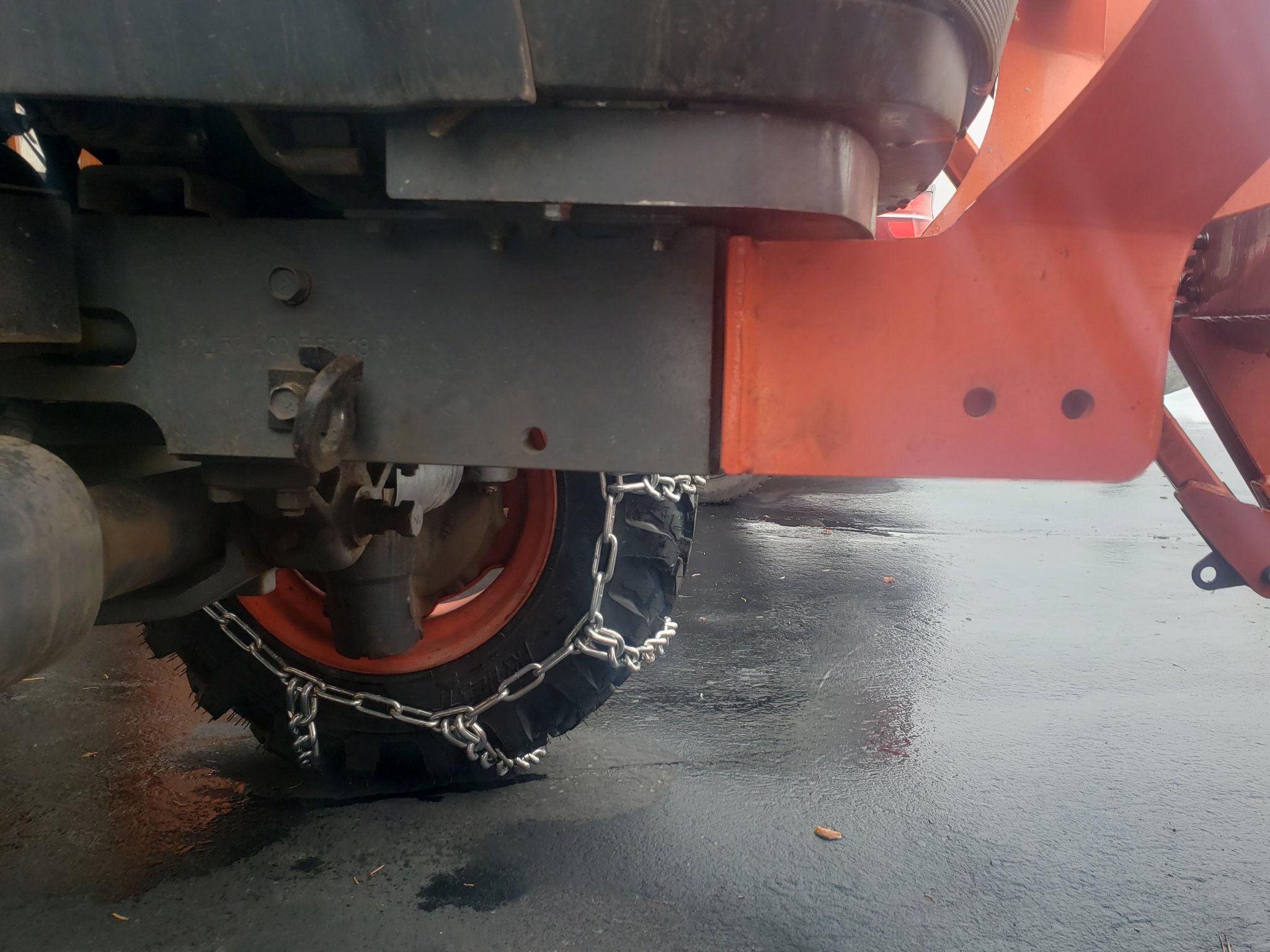

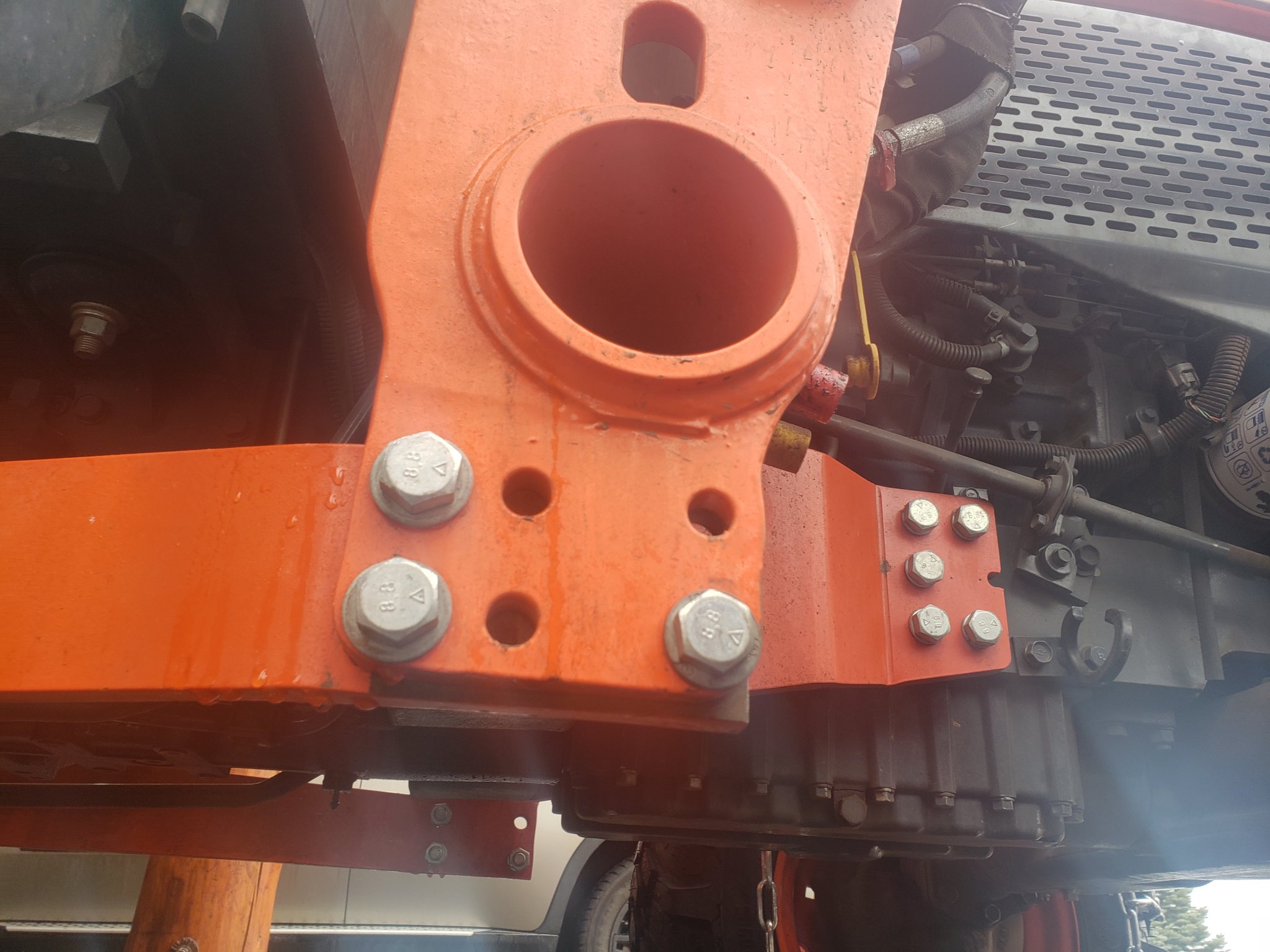

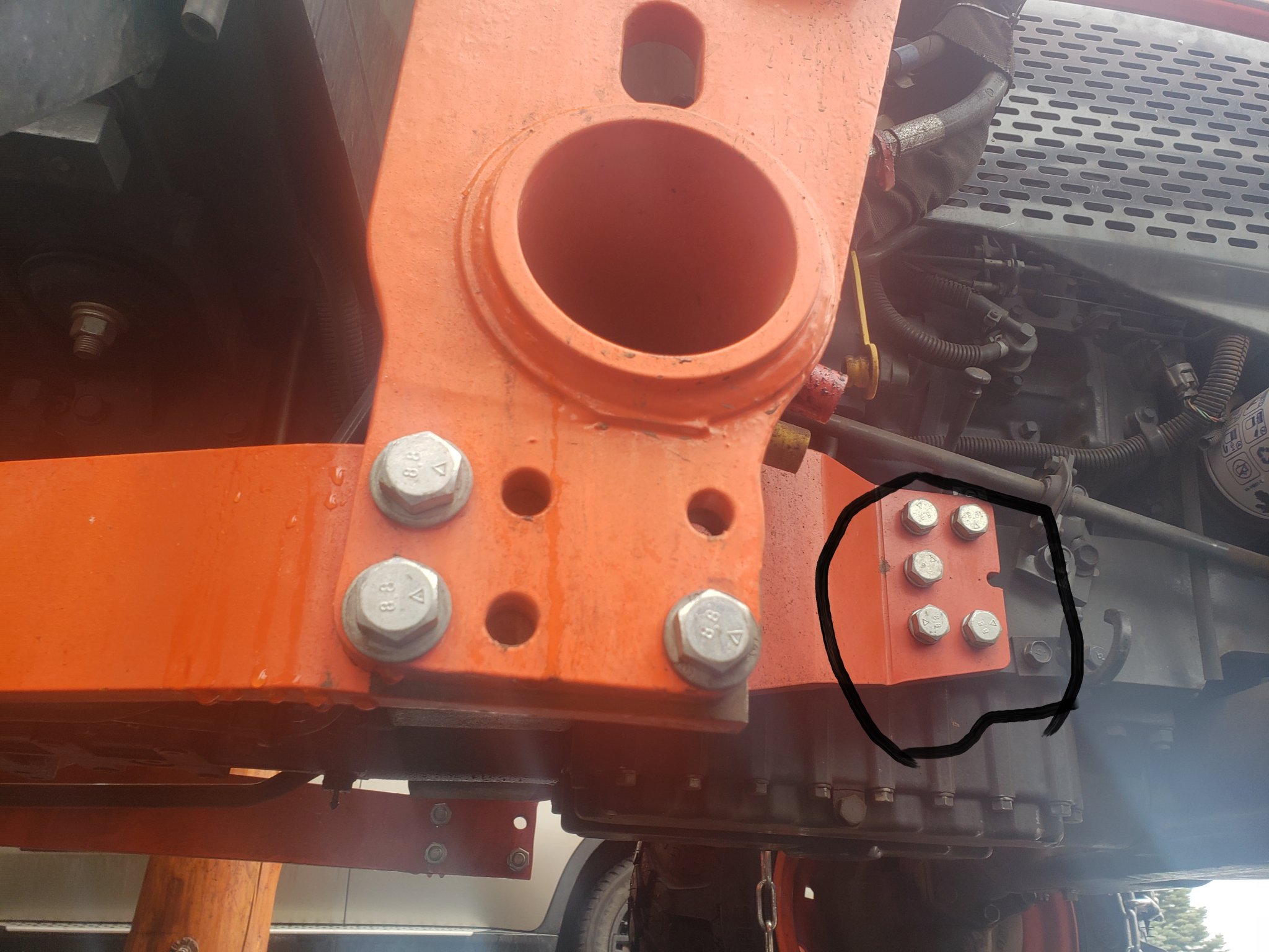

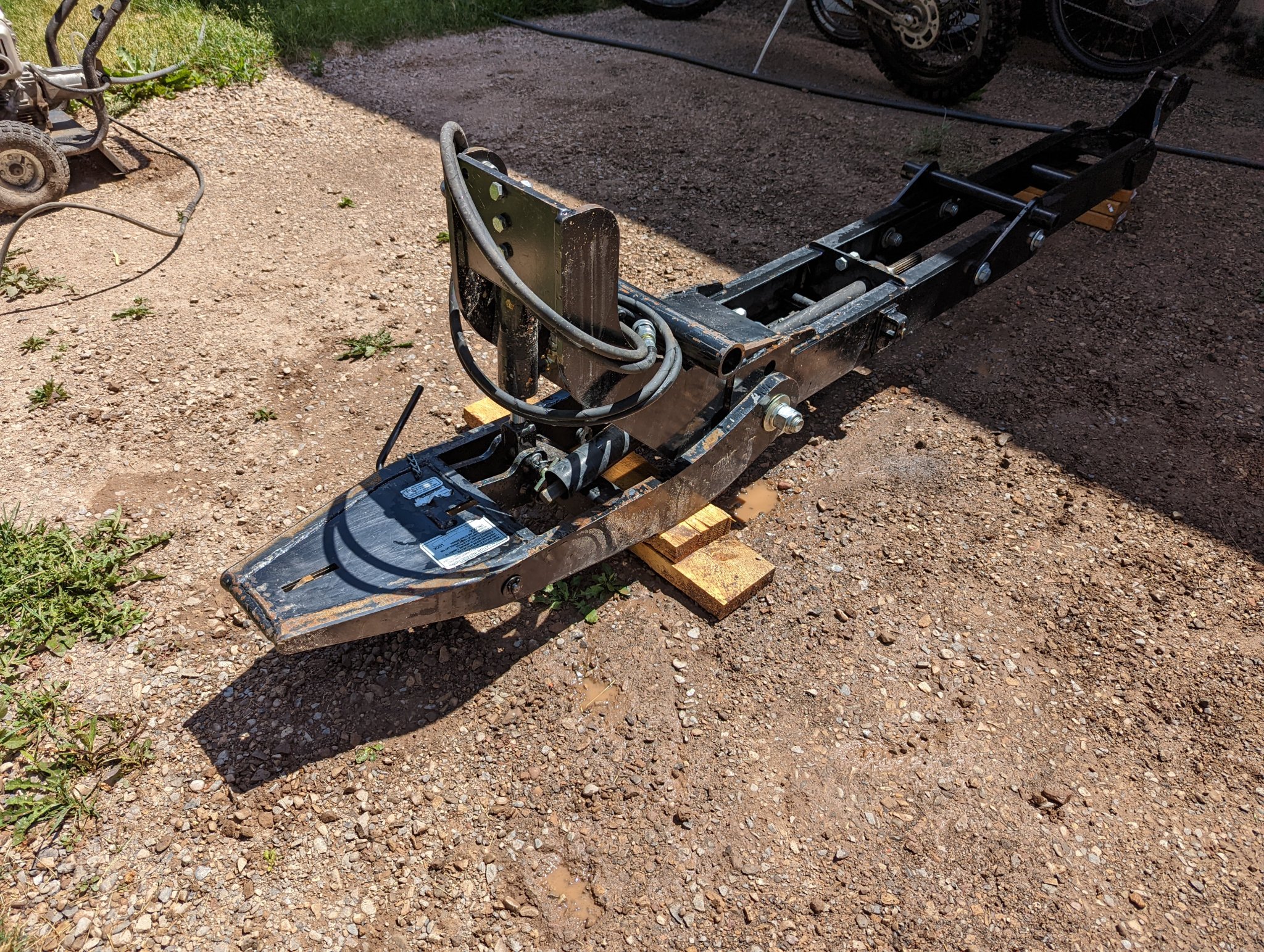

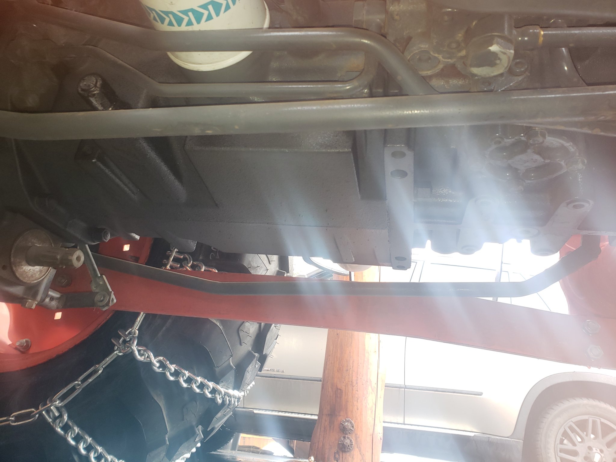

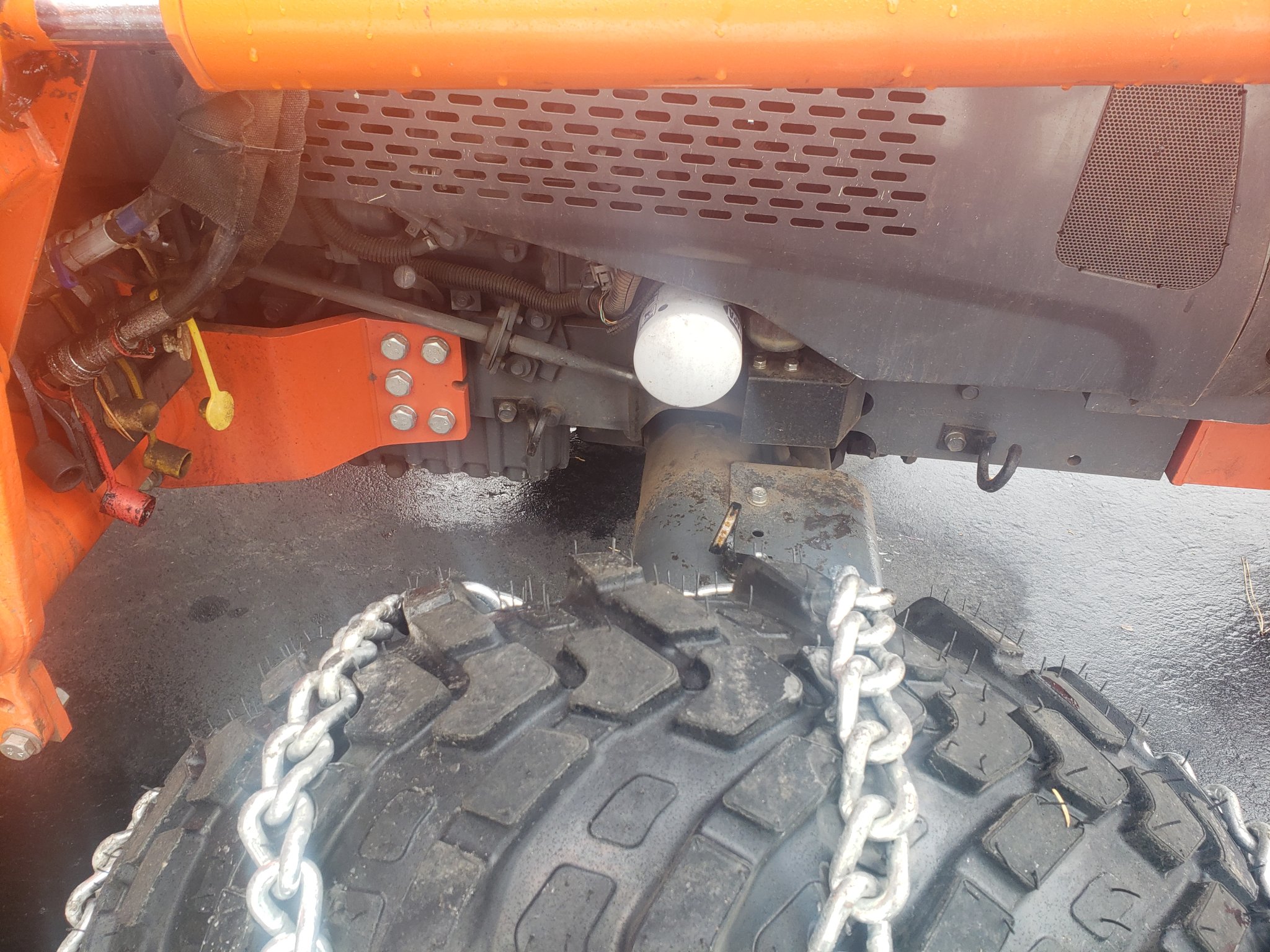

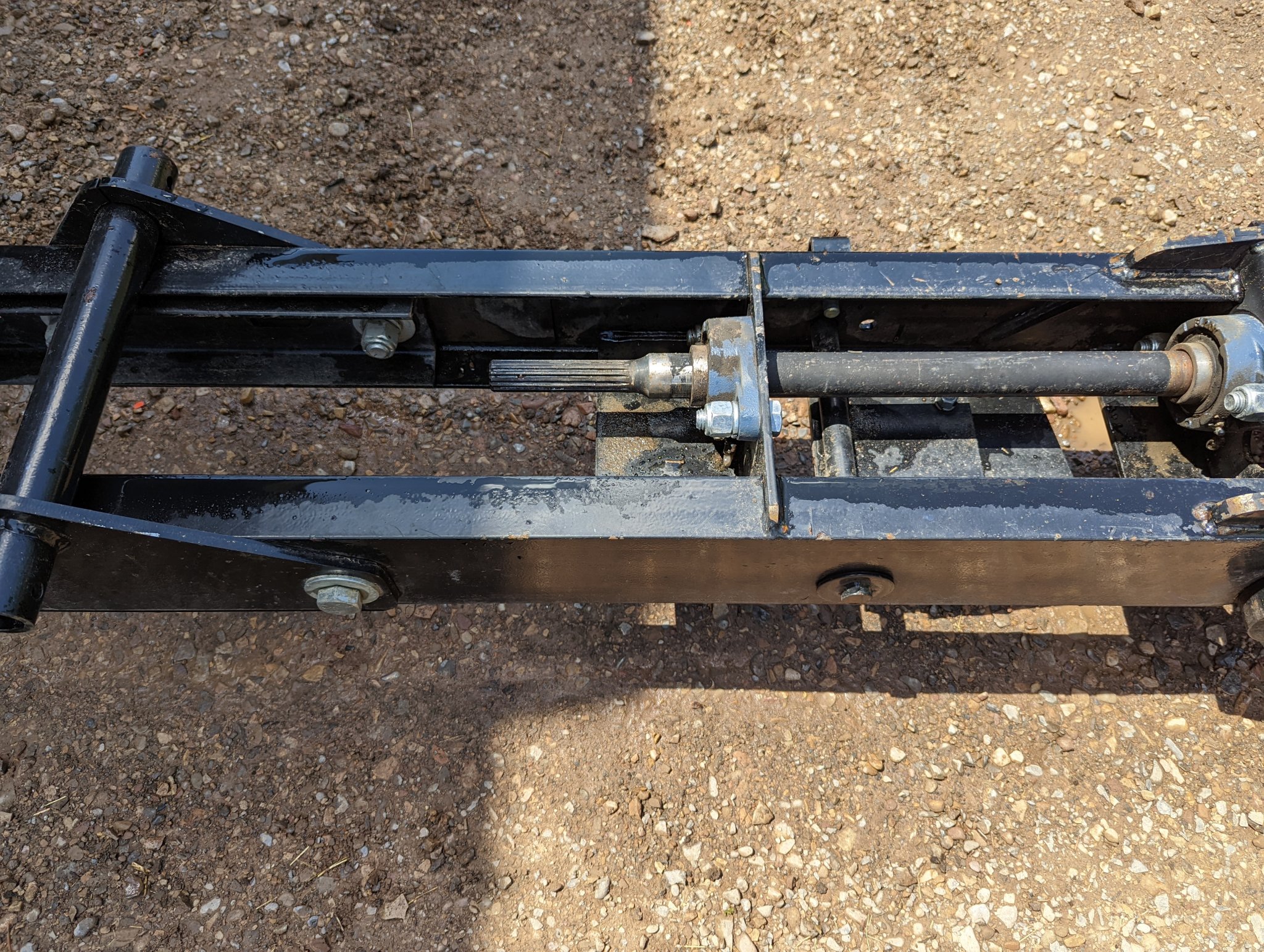

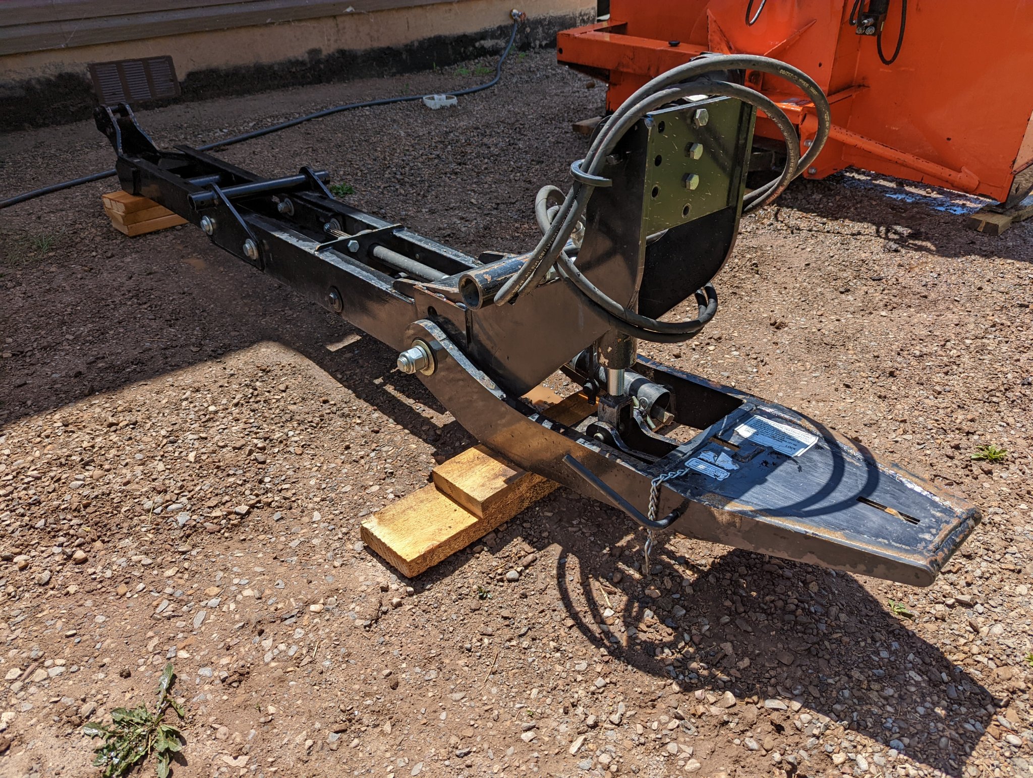

I have a 2011 l5740 and a K connext system set up abd a front snow blower I have never hooked up the K mount
Looking at the K mount and the tractor frame it looks like the back of the K mount slides into the drawbar but I do not see how the front hooks up to the tractor frame
This is the older style K mount and I can't find any videos on YouTube on how to installit
Can anyone give me guidance on how to get it installed?
6,237
4,816
Post some pictures of the hitch and include the data plate so we can help research it.
6,237
4,816
That isn't a K connect mount. It is the older type of connector. I believe that is a B2714C hitch. There is a foil decal on the front tongue. See if you can straighten it out and get the model number off of that.

Thank you for the diagram thats interesting its a different system
Looking at the diagram that you shared vs my unit they are different

I have looked a over YouTube site an assortment of different keywords and cannot find any that have my same exact unit
