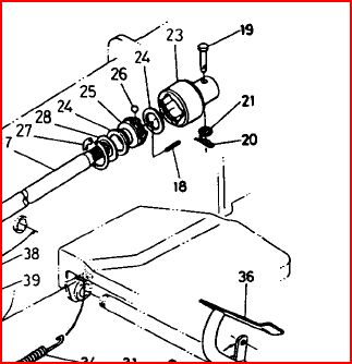

pic attached of the joint on the b6000 prop shaft, it will fit the splines on the 1st output shaft from a 6100/7100 gearbox, possible the reverse may work with the joint on the 6100/7110 setup will fit the b6000 prop, but there may be diff in overall lenght, i will be tyring that too.

I think Rob was grasping at straws, no offence intended.
The #1 reason that the PTO turns the opposite direction, is that the engine turns the opposite direction, I highly doubt that changing the rear end is going to change the PTO rotation.
I do think you would end up with a tractor that would have 4 reverse gears and one forward gear. :eek:

Meh, I was hopeful.... I knew the engine turned in reverse, but wasnt sure if there was an additional gear in the 6100, but now that I actually th8nk about it, regardless it would do the same thing... Oh well. I guess a reverser is the way to go then.

Dave,
Look at the blueprints of the engines in question (ZL600) (D750), the intake and exhaust are on opposite sides of the 2 different motors.
And no you can not turn a 4 stroke diesel engine the opposite direction and make it run.
