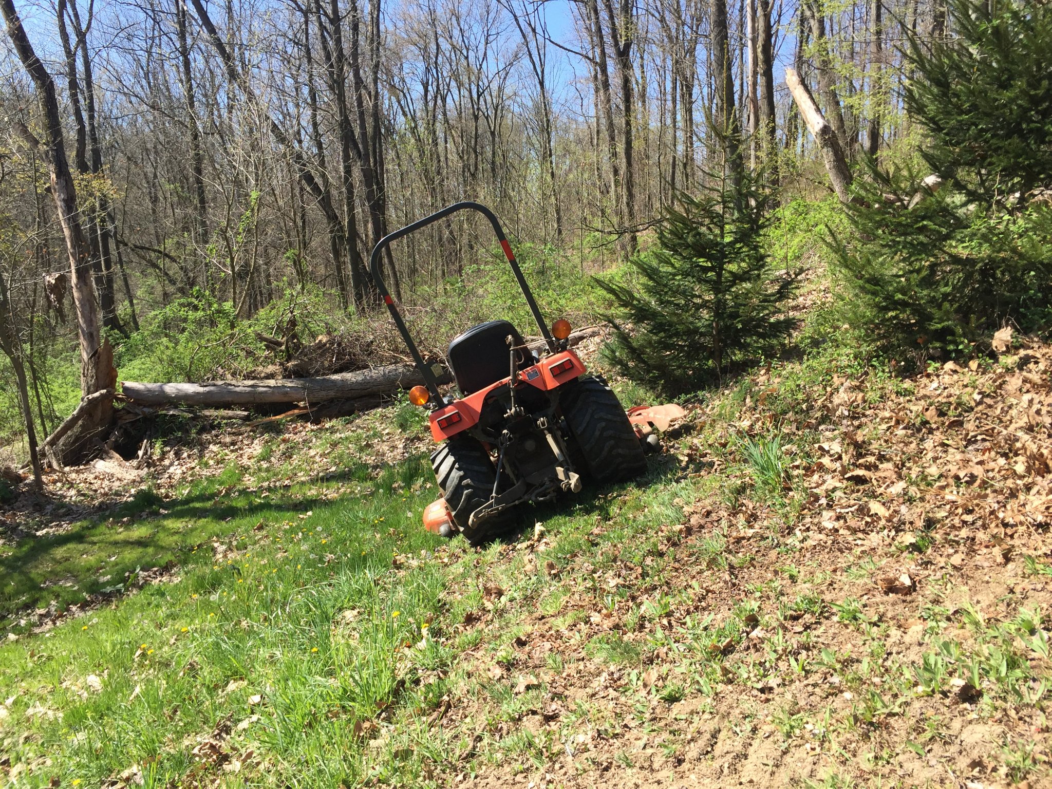

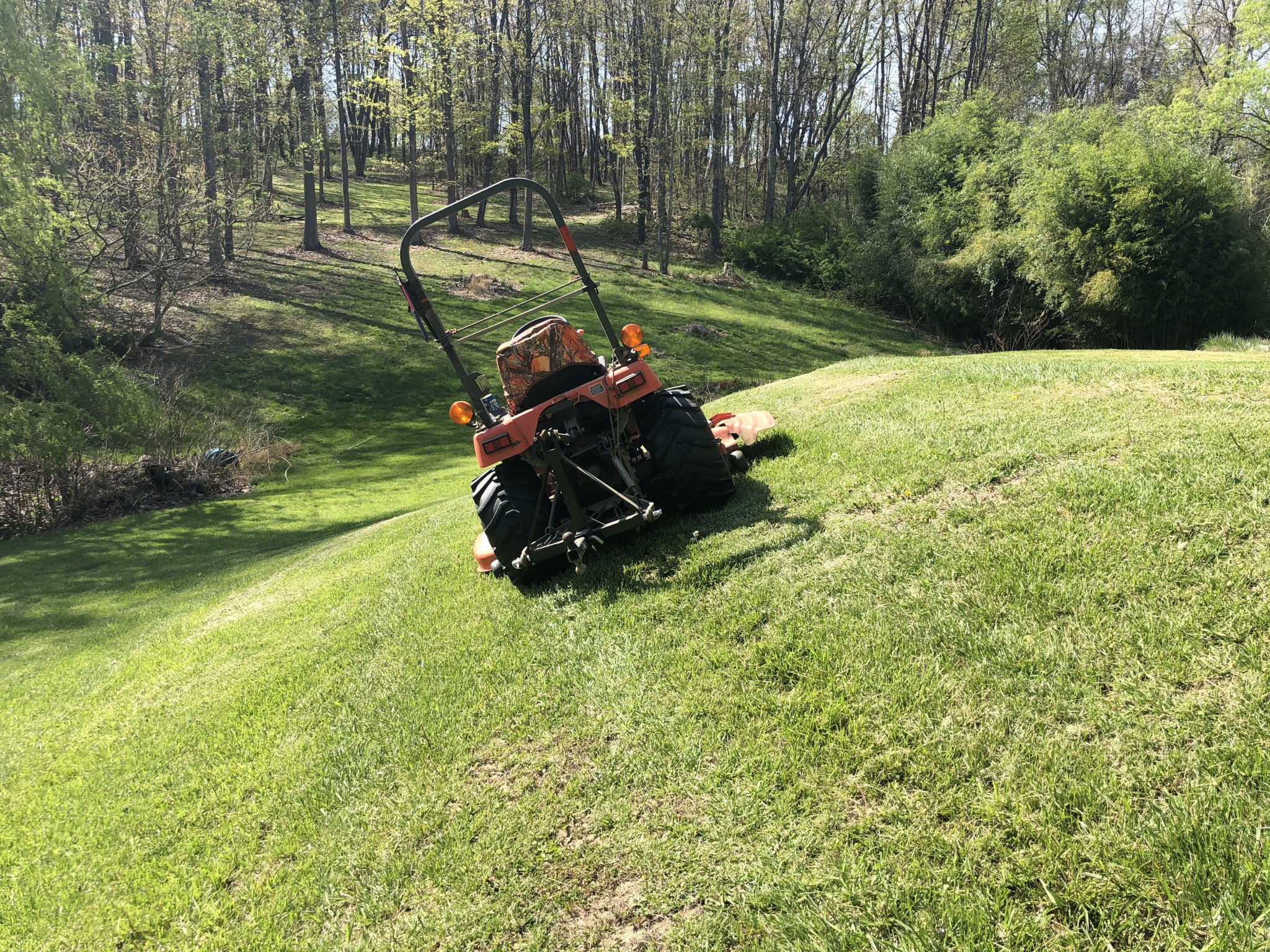

this is my BX2200, Foam filled tires front and rear. I think 1.25 inch wheel spacers, and the mower deck, adding a lot of weight down Low. It seems to be rock solid on these angles, but I’m not comfortable sometimes and I always wear my seatbelt for what that’s worth.
Just posting these photos because the OP mentioned his main interest was a BX
I don’t like mowing on relatively steep (for me anyway) cross slopes. But doing it otherwise takes a lot more time and I think I’m able to do it safely, because when I got off the tractor for these photos I did my best to try to turn it on the side, but it was rock solid. Not that I would’ve pushed hard if I felt the high side wheels, lifting the ground, but they were rock solid in their position..
Just a data point. No measurement. Nothing. Other than the photographs...😉
