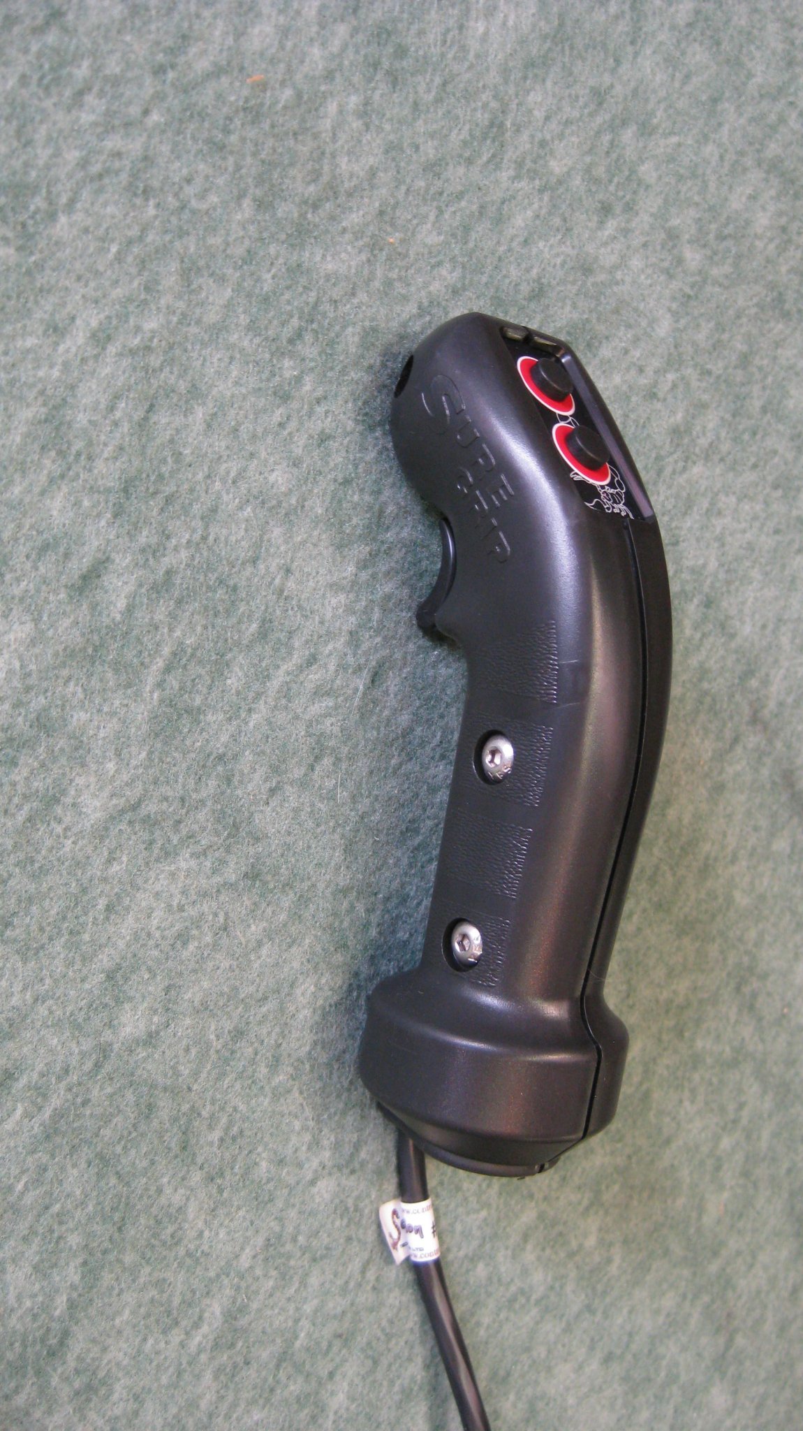

The joystick is connected to a hydraulic valve but I assume you’re adding an electrical linear actuator? I don’t know how that would be connected to the joystick but you might be able to add some type of switches that are activated by the joystick. There is a member here that added some sort of joystick that has some electrical switches in it but I think they control hydraulic selector valves that the joystick controls cylinders through the hydraulics still.
I don’t remember exactly what it does but see this thread or search for “scorpion” by user Mcmxi for other threads.
