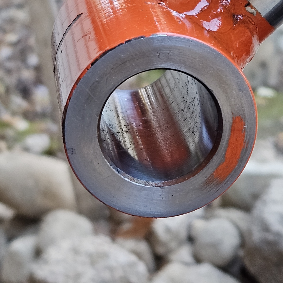

I'd pull the pin, disassemble, clean and inspect everything, re-lube and reinstall, then pump it up with grease. Never hurts to pull maintenance and see what's going on in there, at least for me it's educational and prolongs the life of that part, and from the lesson(s) learned prolongs the life of other parts. My pins take a beating, lube every 10 hours is not enough if I want to minimize wear, and I sure don't want to be replacing bushings when I could pump a little more grease.
