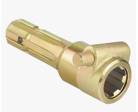

I have one, a Harbor Freight variety. For the cost, for a Cat 1 machine, it's hard to beat. You might need to get the top hook that extends out another 1" but it's like $20 on Amazon. I spent a little bit of time getting all my implements set up the same, and man is it sweet, especially now with the hydraulic top link, I can drop and swap without getting off the tractor. My PTO implements all had enough overlap to be safely used without buying new shafts. I did buy some cat 1 to cat 2 conversion bushings on Amazon but for ease of hook up, and not having to leave the seat, well worth the investment to me.
3,959
7,031
Yes, I think its worth it.
For your pto driven attachments, you can get a PTO extender. They are about 4 inches long and will make up the difference that the quick hitch pushes your implements back.
Something like this:
Reactions: 8 users
Sidekick
Jul 29, 2023
1,294
1,892
N.Y,
That would definitely make the pto easier to access. Wonder if they fit tight or add wobble.
Thanks, you talked me into trying one. After a search I found one from Speeco that doesn't need bushings on sale for $199.00 with free shipping at a company called Big Tool Rack. I think it's a Chinese import rebranded by Speeco. Seemed like most of them need special bushings pinned on that would be a pain with 2 tractors and only one having a quick hitch. You guys are great at helping others spend money 🫢.

3,959
7,031

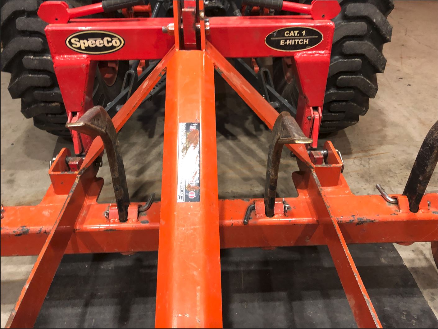

I have a pto extender. Yes, they do add just a bit of wobble but I don't thing its anything to worry about on a small machine.
I also have the speeco quick hitch. Its the "E-hitch". You are correct, you wont need bushings for it.
Thanks for the picture. That is the one I ordered and hopefully it will work on my attachments with open pins also. I wanted black but this model only seems to come in red. I have a can of truck bed liner to fix that. I have used the spray over powder coat before withgood luck. Just measured my old post hole digger and that isn't going to work with it but luckily it only gets used about once every 2 years. Now to find 3 point extender to try. Found a cheap top link on Vevor that's about the right length I think I will try to start. Originally I had seen a quick hitch at harbor freight for $79.00 but didn't like adding bushings to implements and having to remove them for the BX use. My back needs a break and hopefully this will help.
