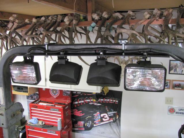

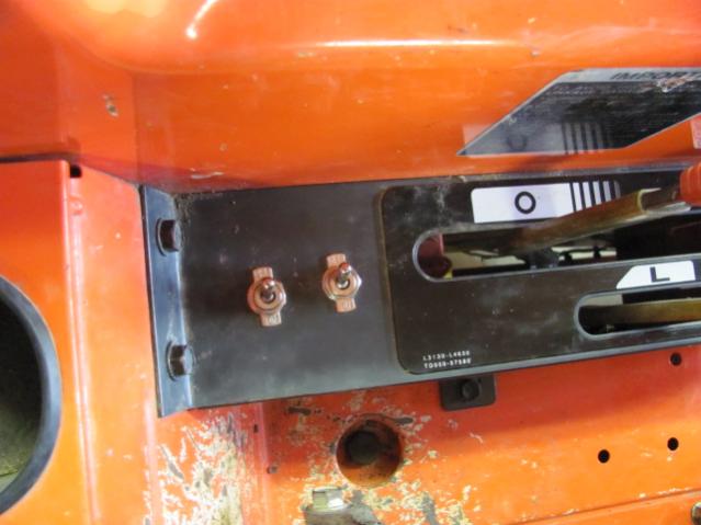

I just mounted lights on my ROPS Thanksgiving week I sourced the lights off the back of the fuse block , I attatched to the large wire coming from the ignition so if any lights left on I wouldnt kill my battery. I also fused the front lights and the back lights separtly using inline fuses see photos

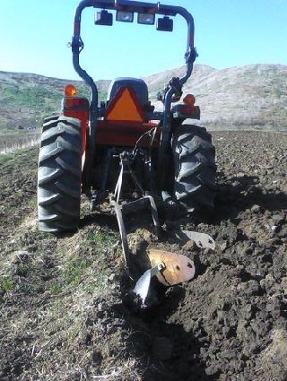

I did pretty much the same thing on my 2360, the bracket on top of the ROPS with 2 55watt off road lamps,, wallyworld I think like 25 bucks,, the bracket is wide enough for both lights and stands about 2 1/2 over the ROPS i use a 2x4 to brake the street sign I found, I made clamps and used 4, 3 inch bolts to clap it to the top of the ROPS. ( I would post a pic but for some reason I cant seem to get things loaded)
I ran a line off the battery through a 15 amp inline fuse and placed the switch on the grill cover that covers the battery. The lights work well, though if you have any over hanging branches they will clean the lights off,,,, dont ask,,,, I thought about mounting the lights under the ROPS but my head gets in the way.
I also mounted a 55 watt driving lamp where the hazard sign use to be, made a bracket and bolted it in place for use in backing up, you know just to see what Im backing over.. total 165 watts (I dont use the head light with the plow as they are useless).
So far I have no had no power isuses as long as you keep the rpms up the battery will be ok other wise it is a drain, I also have a sears battery tender I keep hooked up in the winter 30 bucks, I use the same kind for the Harley Battery in the winter.

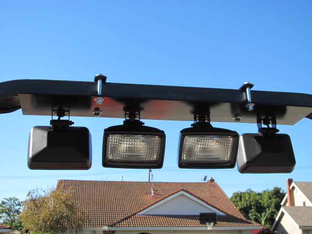

I just bought a piece of flat stock and drilled and painted and as you can see I sandwitched the ropes with it to avoid drilling the rops, very simple installation if you need more in fo let me know I can e-mail you more pics.....Dan
