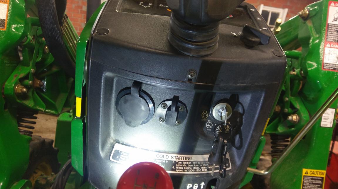

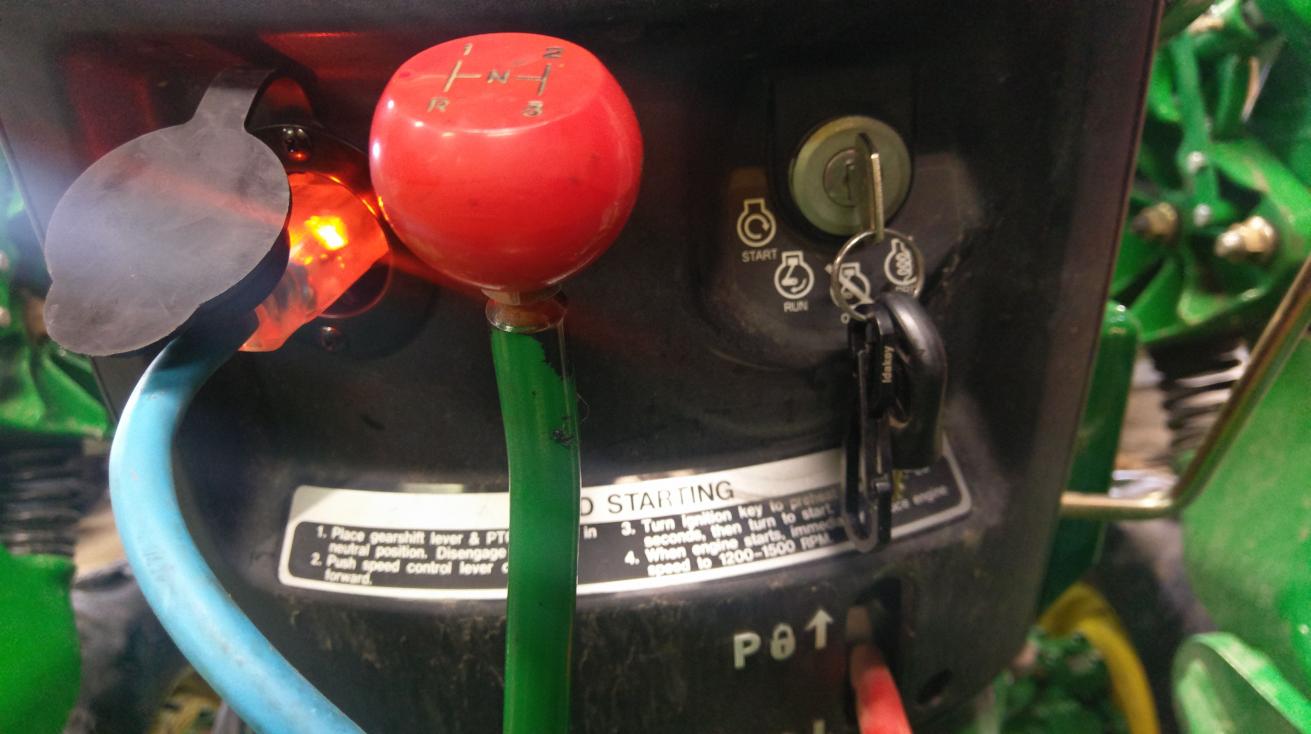

SRG
B8200D 4WD........ JD 870, FWA, 300x FEL.......... JD 797, 72" Z-Trak
Jul 15, 2017
490
N. IL
I installed a block heater and a battery blanket on my JD. Then routed both of them to one convenient plug mounted under the steering wheel....
The small plug on the right, is for the battery tender. The large on the left powers the block heater and battery blanket.
