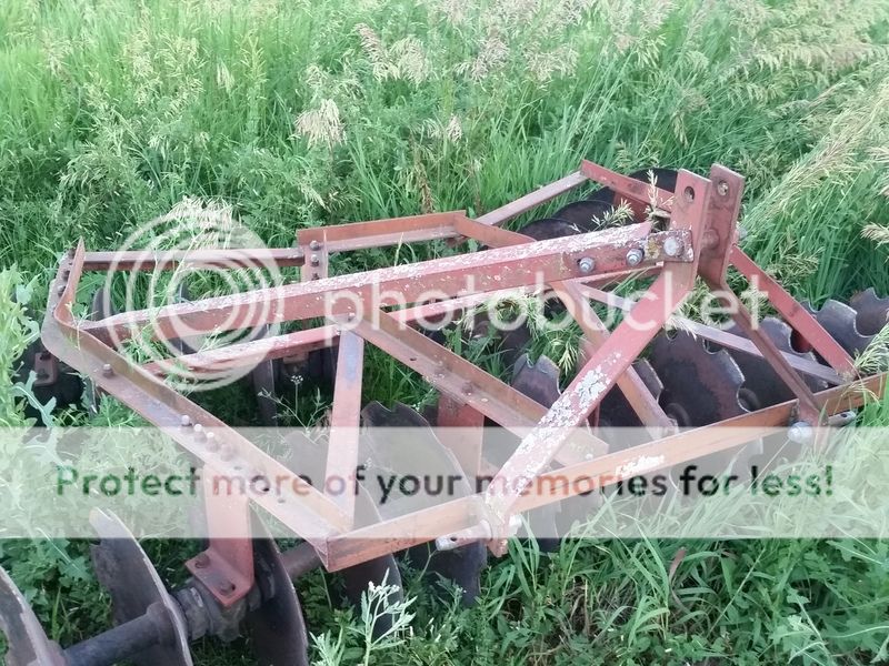

Here is the Disk I bought. This is before I put a hedge log on the back. I will add some more logs to the front half of the disk.
But you can see that the front disks are not offset much. So I will move the attachment points to increase the angle.
I will double check to see if I have other adjustment holes on the 3pt to allow it to let the disk run deeper.

Those disc do a good job of cutting forage and breaking the ground. Might straighten the rear gang, and add more weight. Then work at a different angle until you get the soil the way you want it.
