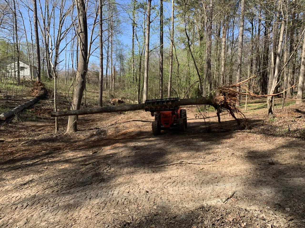

FWIW, when comparing loader lift capacity - you also have to take into account the range in which the loader functions. By range, I mean not only maximum lift height, but also the distance the load is carried away from (in front of) the tractor. Loaders with longer arms will not lift as much, but they can be much more useful - especially when dumping into a walled container (dumpster, truck bed, trailer and etc.). It could be that your Kubota is simply engineered for more range/distance versus other brands that design more for weight.
You may have already considered this issue - or not.

Well yes and no. I did by looking at the different lifting capacities and all were listed at the pins. What I did not consider and what it sounds like you referring to is the length of the arms in relation to their lifting and anchoring points. No I did not think of that in the least. Good Point! Thanks
The equivalent tractor to your L6060 with the LA1055 loader is probably an NX6010CH with the KL6010 loader. The Kioti loader has a higher rating at the pivot pin of 2,761lb compared to 2,361lb, but the LA1055 has 7" more reach at the ground, (Kioti doesn't list the reach at max height but Kubota does), and the max lift height is 4-1/2" higher in favor of the LA1055. Also, the breakout force of 2,990lb for the Kioti is listed at the pivot pin, but it's 3,171lb for the Kubota 20" forward of the pivot pin.
So as @Elliott in GA stated, some manufacturers focus on numbers that will impress the customer and others focus on the bigger picture. I'm currently using the LA1065 on my MX to load dirt into a dump trailer. Given the height of the side panels, and the location of the fenders, and the fact that I'm nowhere near the max load with the weight of the bucket (from the M6060) and dirt, it's the ability to reach up and over and dump the load that's important to me, rather than the ability to raise 2,761lb at the pin.
You might want to watch this Messick's video; it covers many of the trade-offs in design/functionality.
