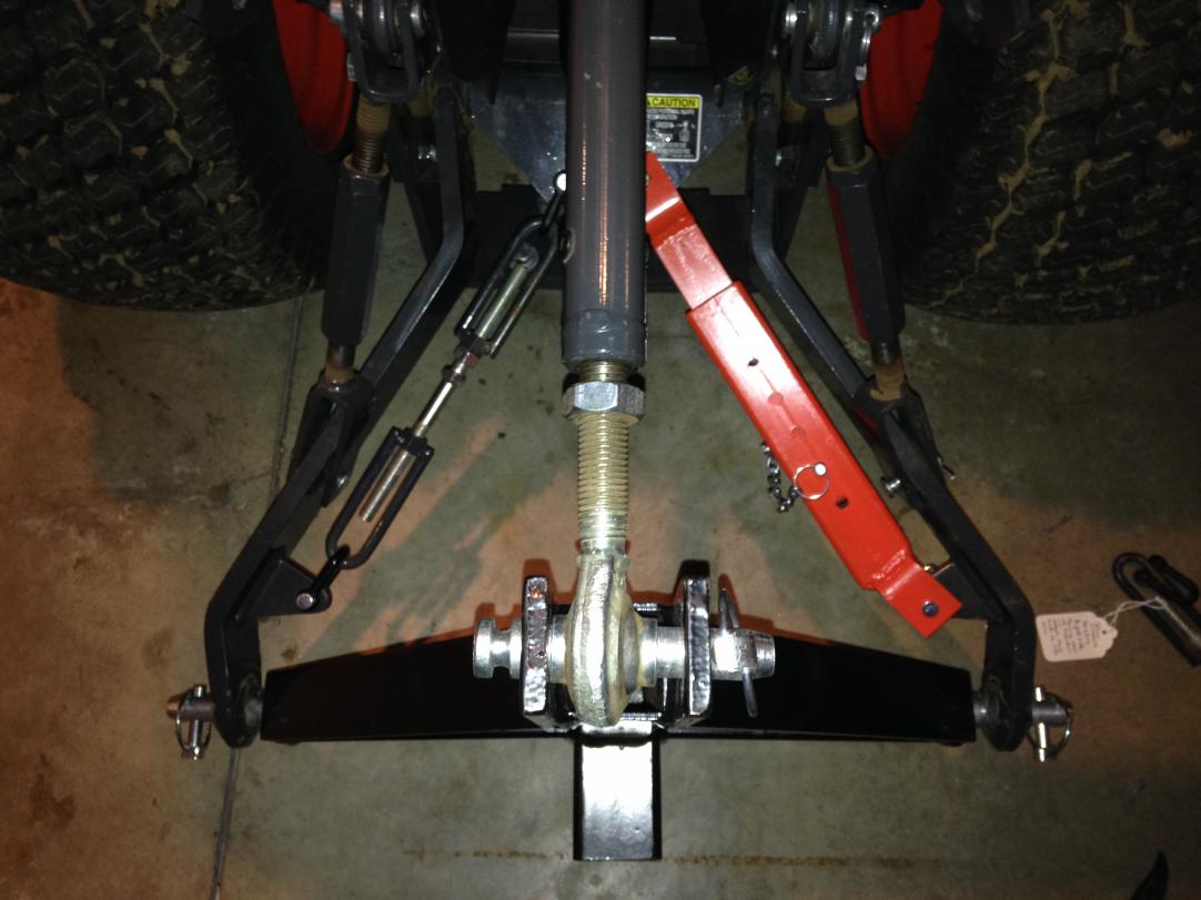

First recommended attachment, Mark Hodge's telescoping stabilizers. For anyone who has had to deal with the stock turnbuckles when wedged between the tractor and an implement, these things make it so much faster and easier. Not only do they work great, but they are very reasonably priced at $180 for the pair (including shipping). Contact Mark at markhdg@gmail.com if you are interested in a pair.
https://youtu.be/lPjXpXZpaNA
I attached a pic of the 2 color options that Mark can provide. I asked if he can match the paint on the 3 Point Kubota hitch, and this is what he said:
"The grey paint is lighter than the Kubota Blue. I've used Kubota Blue in the past, but I wasn't very happy with the quality of the paint or the curing time."
I went with the orange since it matches the tractor better than the grey.

Attached is a picture of the first turnbuckle replaced with Hodge's stabilizer. To replace the turn buckles, there is a pin at either end held on with a clevis and split pin.
Hodges instructions for install (and it really is this simple):
"Install the new stabilizers with new clevis pins at the lift arms, and grade 8 bolts at the pivot plate. I use bolts at the plate because under severe load, the shock to the plate could spread the brackets open. Tighten the two bolts and install the clevis and pins, and you are done."
It took longer to get the split pins off than to install both of the replacement arms and take the video above.

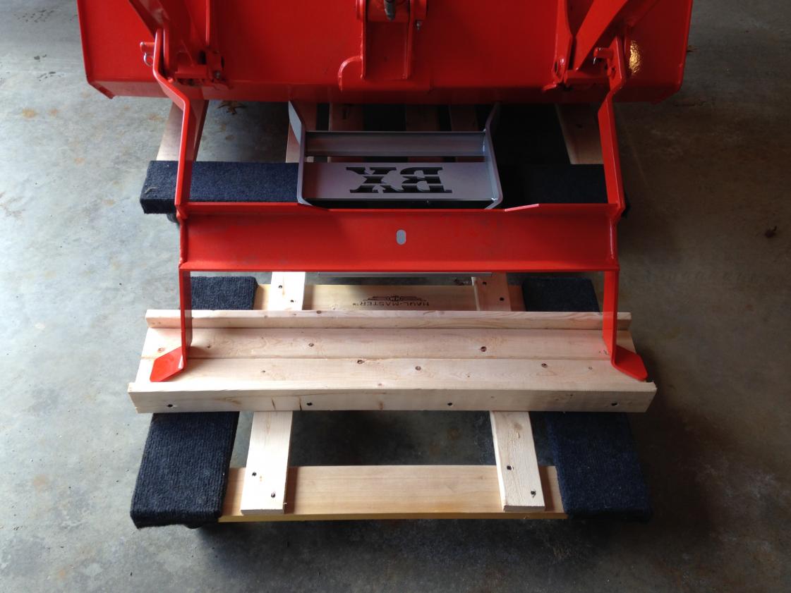

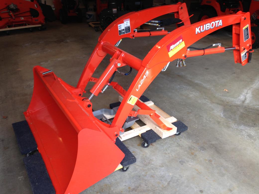

For the FEL, I have the stock one that comes with the BX2370 (the LA243). I made a dolly for it using three movers dollies from Harber Freight on sale ($8 each). I used some spare 1x4 and 2x4 material to strap them together and make a catch bar for the feet to sit on. I use the lip of the dollies to catch the front of the bucket.
Once the FEL is disconnected from the tractor, it rolls easily anywhere in the garage. It also means I don't have to move the tractor to hook up the FEL, I just roll it up to the tractor and start hooking it up. I can also store the front bumper on this dolly when I have the snow blower on the tractor.
I will take a video next time I do this process and post a link here as well. Pictures attached below.

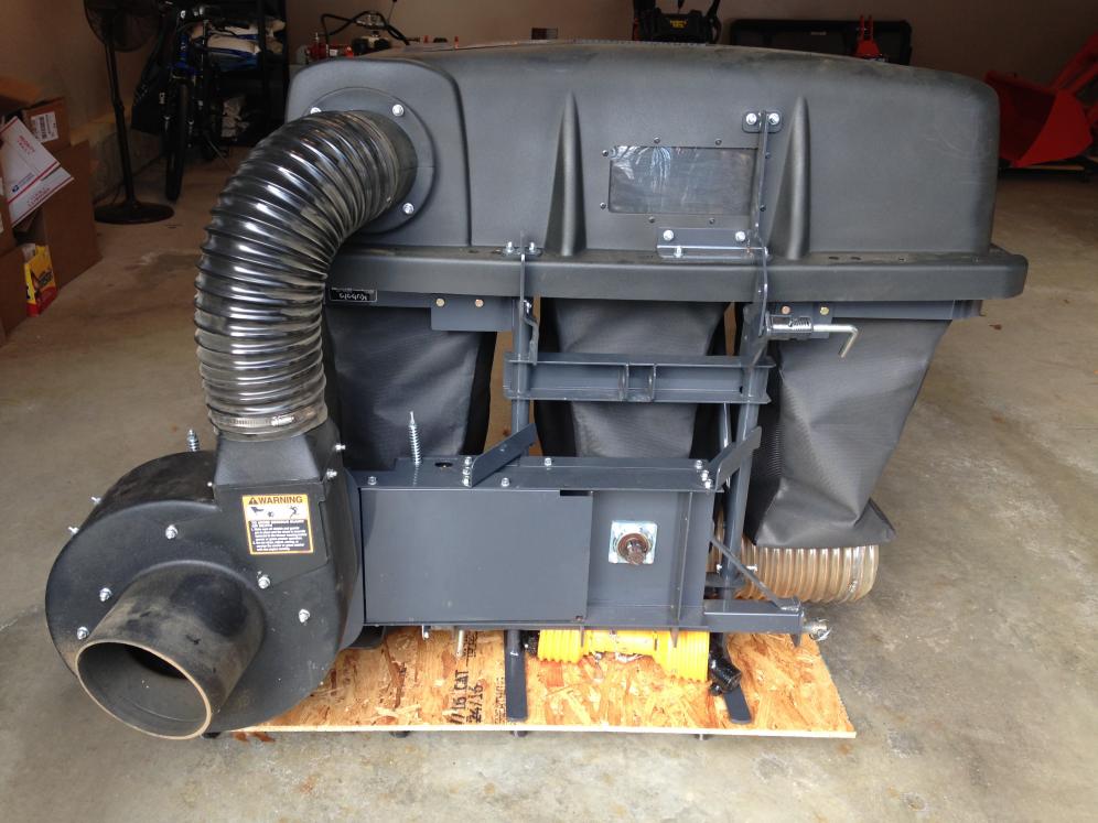

The Kubota bagger for the BX series is the only implement so far that I have not been impressed with the design for attach/detach. All of the other implements work really well for quick attach/detach, not so with the bagger. Since the bagger requires the 3 point lower arms be attached to static mounts (not the hydraulics) there is not a good way to lift the bagger up onto a dolly.
My solution was to take out the 3 feet, and drill holes lower down the pipes to give a new pin position. The original holes are still there for if I want to drop it directly on the ground, or I can use the new holes and drop it onto my dolly (picture attached).
This combined with the new telescopic stabilizer should make the next round of attachment much easier. In the spring I will take a video and post the link here.

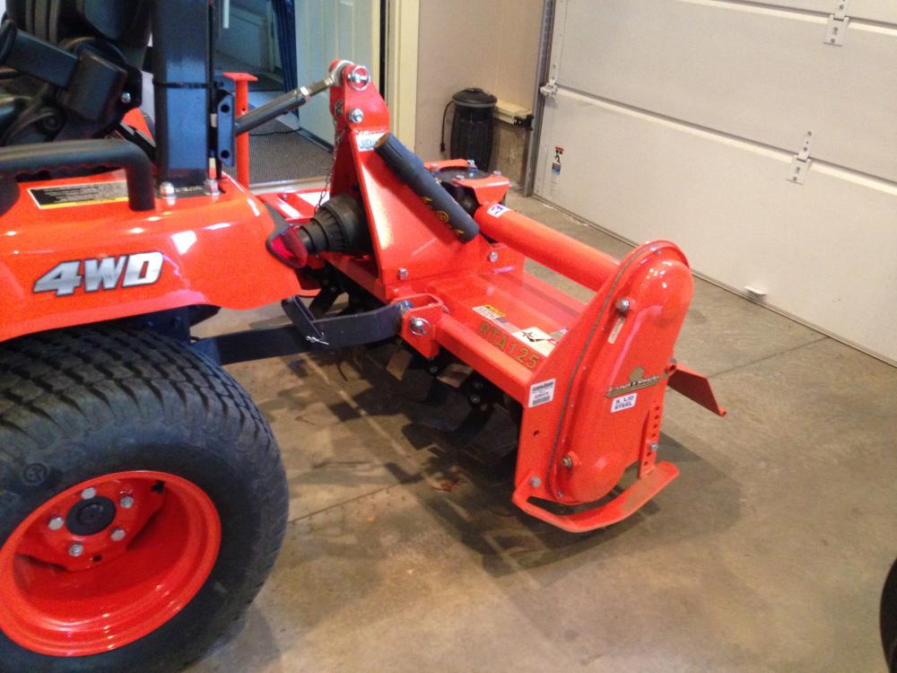

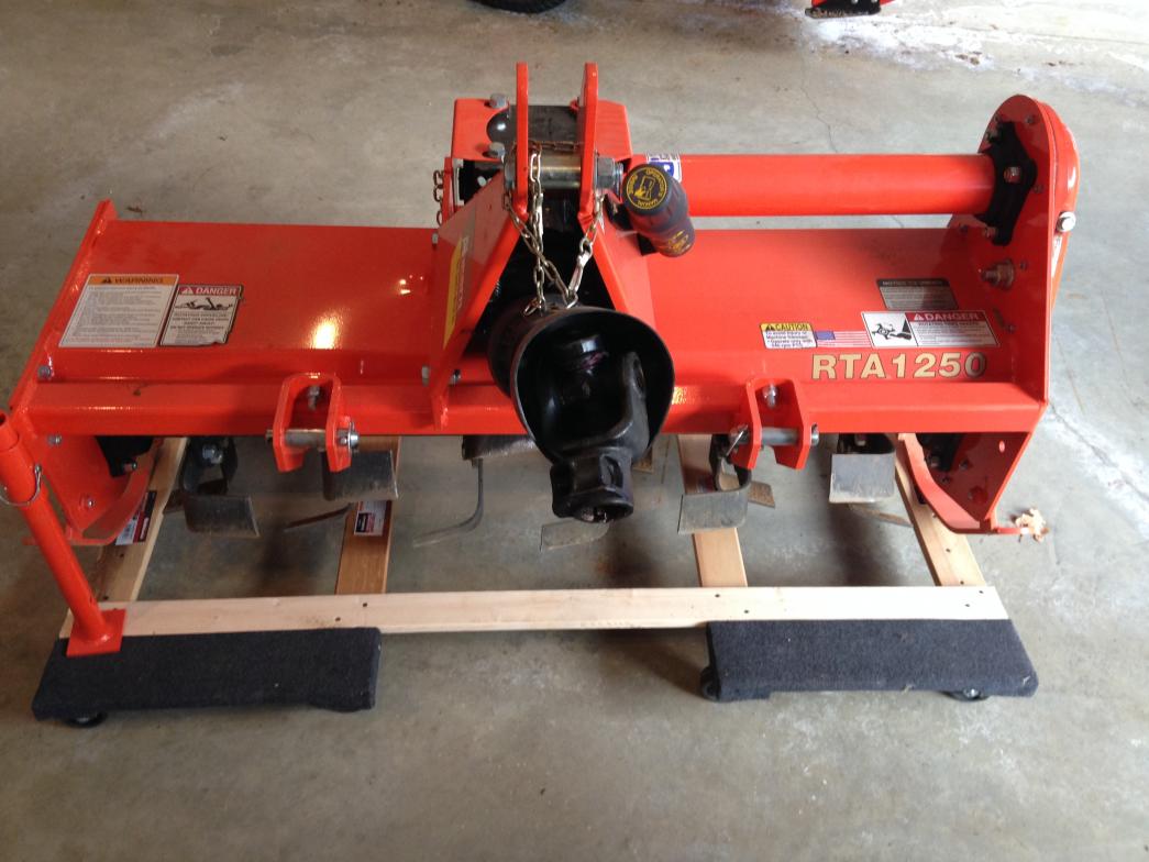

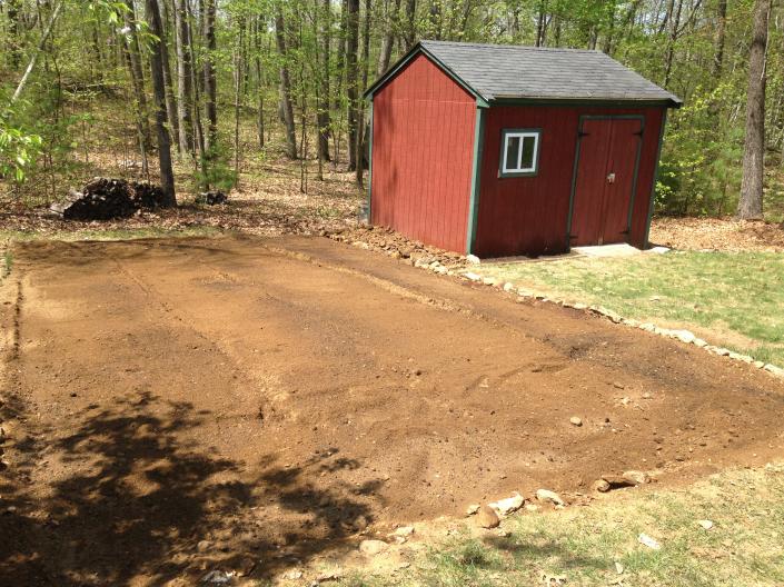

Next up is the tiller. Purchased from Land Pride, model RTA1250. This thing made a huge difference in the soil quality in our garden this year. Got out a ton of rocks that had been about 6" under ground. I just couldn't get that deep with a walk behind tiller. The attached pic of the new rock garden is all the rocks we pulled out this year with the tiller. That is about 2' x 10' x 4" deep (and there was nothing there to start with)!
Again, dolly made from movers dollies from Harbor Freight ($8 each) with some 1x4's to hold them in shape. The tiller was heavy enough I had to brace the bottom of the dollies with some 2x2's to keep them from bending (the tiller rests right between the wheels instead of over them). I will probably do a bit more to strengthen it this year while the tiller is off of it.
Check back for videos in the spring.

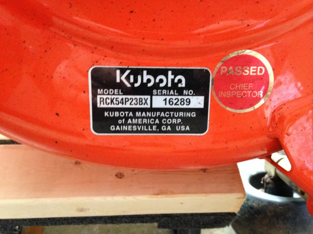

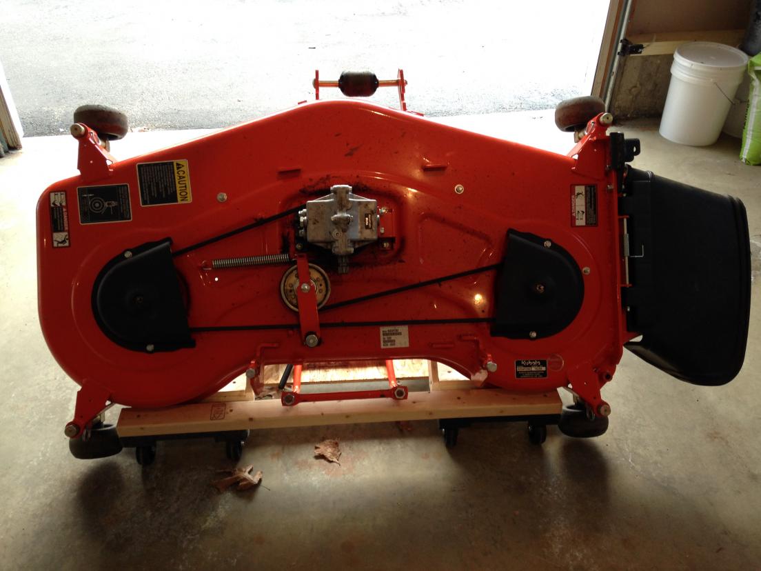

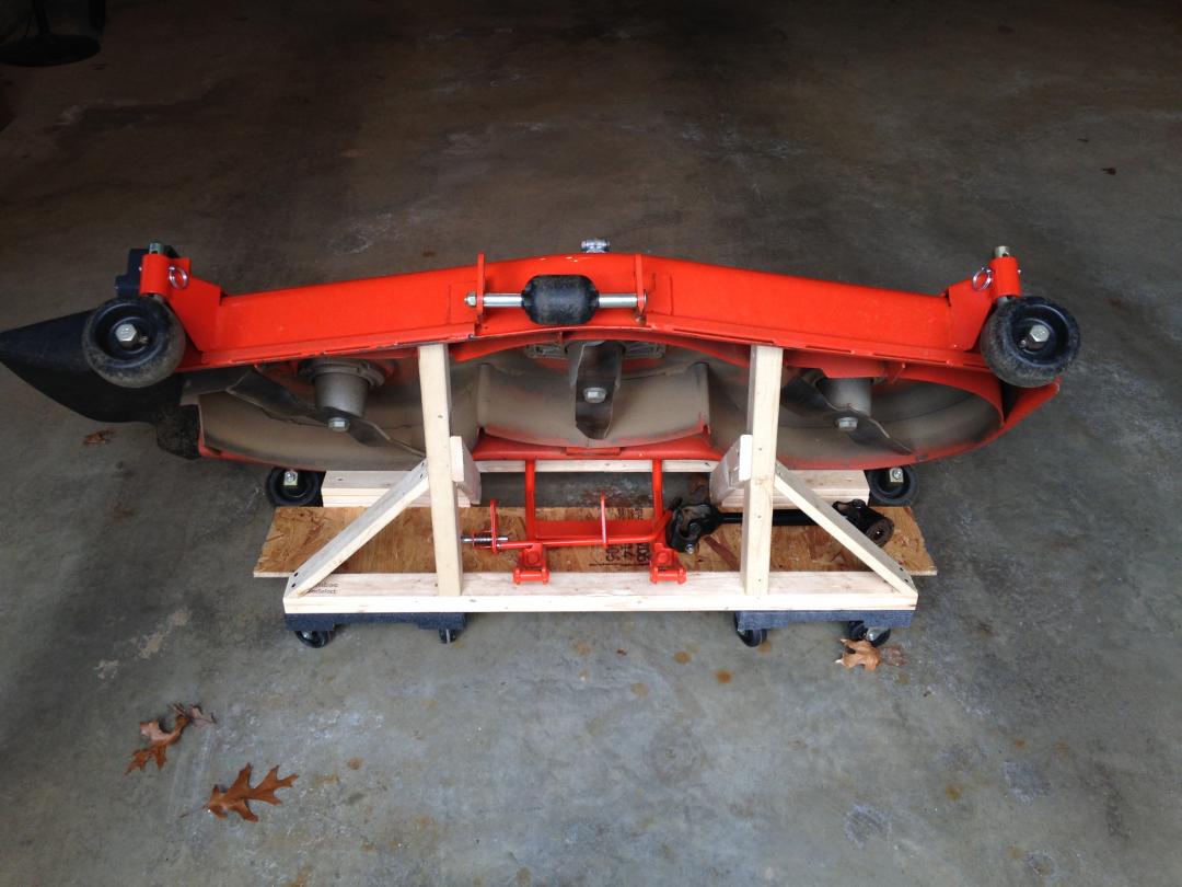

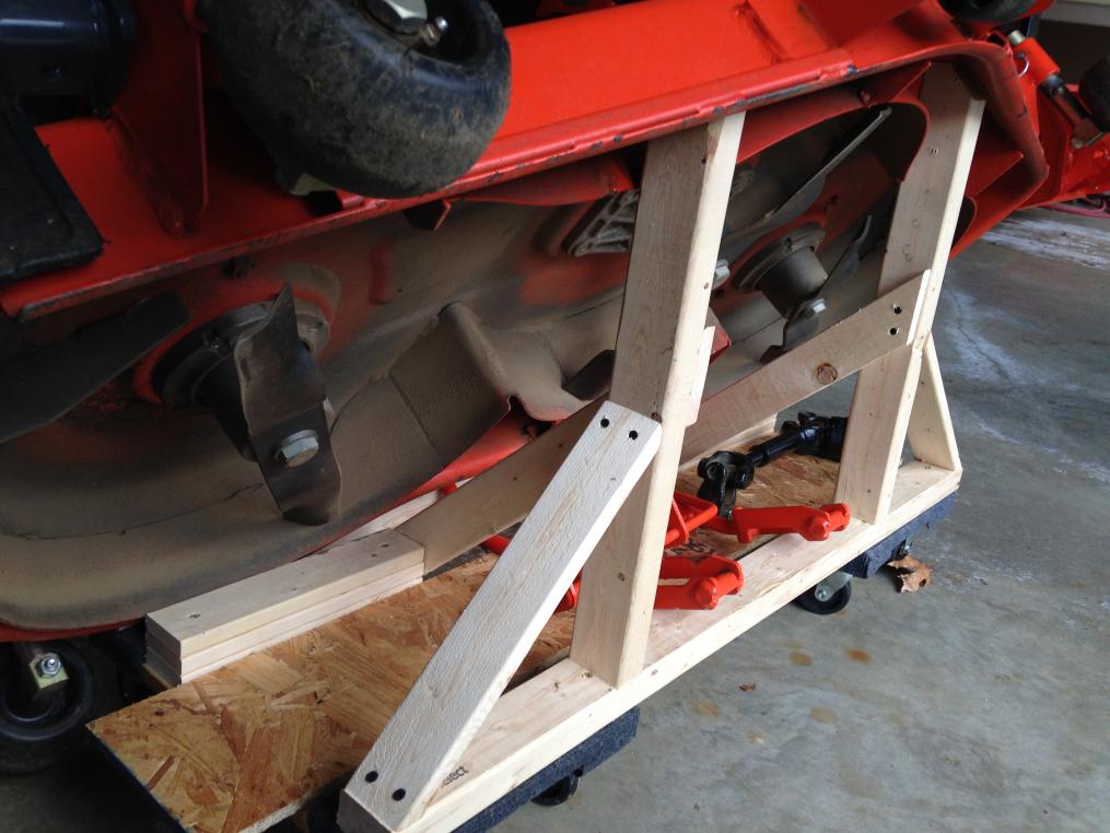

Up next, the MMM. This is the finish mower from Kubota, model RCK54P23BX. This one was a bit more of a challenge. I wanted it to be easy to roll around the garage. I didn't want to leave it flat (since it takes up a lot of space), but storing it completely vertical would have been very top heavy and likely to tip over.
My solution was to build a dolly (again based off the $8 Harbor Freight specials) that would hold it at a slant, so the center of mass was well balanced, and gave me some space under for the other parts of the mower.
Currently I am using the FEL to lift the deck onto the dolly, but I would like to have a hoist installed in my garage that would be used to put this on the dolly, as well as other uses. I haven't decided it it is worth going that far, since it isn't to hard to use the FEL for this purpose.

Jgvicke, love all of your set ups nice job! I just bought a bx1500 and I also have the PTO bagger, my question is where did you get the clear plastic flexible pipe that goes from the mowing deck to the bagger? I have been doing some looking online but a lot of the places you have to buy 50-100'. Thanks!
jgvicke
Kubota BX2370 with FEL, MMM, Bagger, Tiller, and Snow Blower
Dec 12, 2015
25
North Brookfield, MA, USA
The clear plastic is what came with my bagger. I suspect that is one of the changes they made to the later models to let you see if the shoot is clogged up.

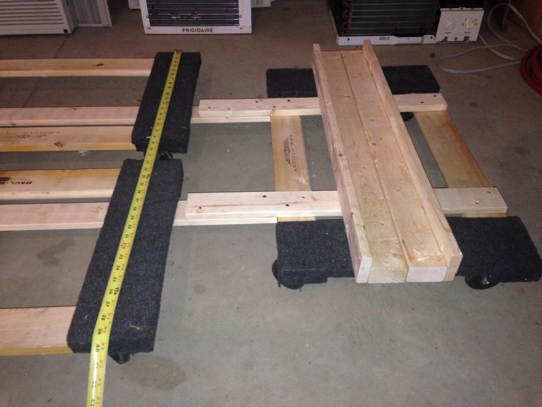

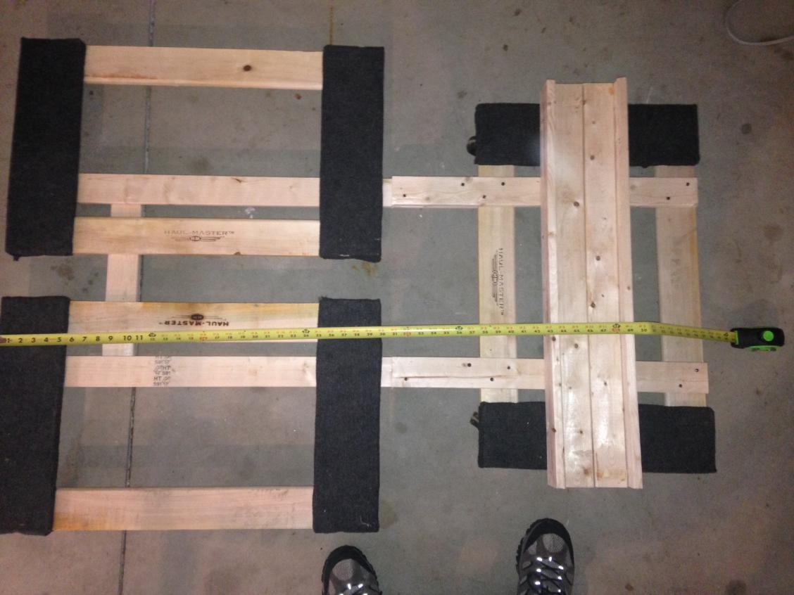

Les,
I have attached some photos with a tape measure so you can see relative size. As I said I threw these together without plans, literally cutting pieces without a tape measure and screwing it together where I thought would work.
If you want to try to make something more exact, I would round off numbers to whole inches since it would still work fine.
I started with 3 of the harbor freight dollies that I got on sale. Here is a current link:
http://www.harborfreight.com/30-in-x-19-in-1000-lb-capacity-hardwood-dolly-61897.html
Normally $16 each, but you can catch them on sale every now and then for $7 each. I purchased a total of 12 at that price and have used them to make all of my dollies for the tractor.
Used some 1x4 scrap material to tie them together so they move as a single unit, and some 2x3 material to support the kick stand in the back. Originally I didn't have the kick stand cross piece, but the kick stand was really tearing up the wood on the dolly (it just barely fit anyway) so I used the 2x3 material to make a wider foot rest. The uprights are more 1x4 and are just used as a guide to make sure the feet land on the 2x3's.
Let me know if you have more questions on the concept.
