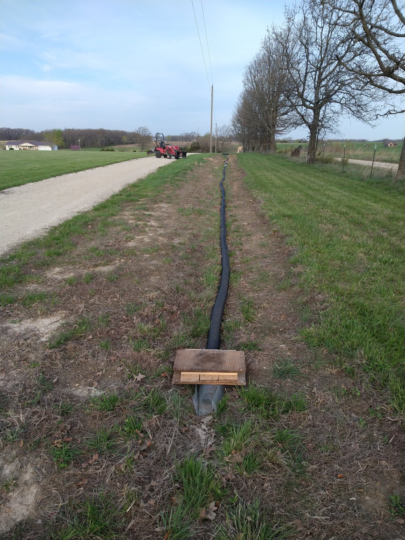

If you can bury the top of a perferated 4" pipe even 2" below the ground, and it goes slightly down hill ... It will drain, off, but if it's perfectly flat, gonna be much harder!
I think you "mole tunnel" will collapse in time, especially if run over by your tractor.
I have clay soil too!

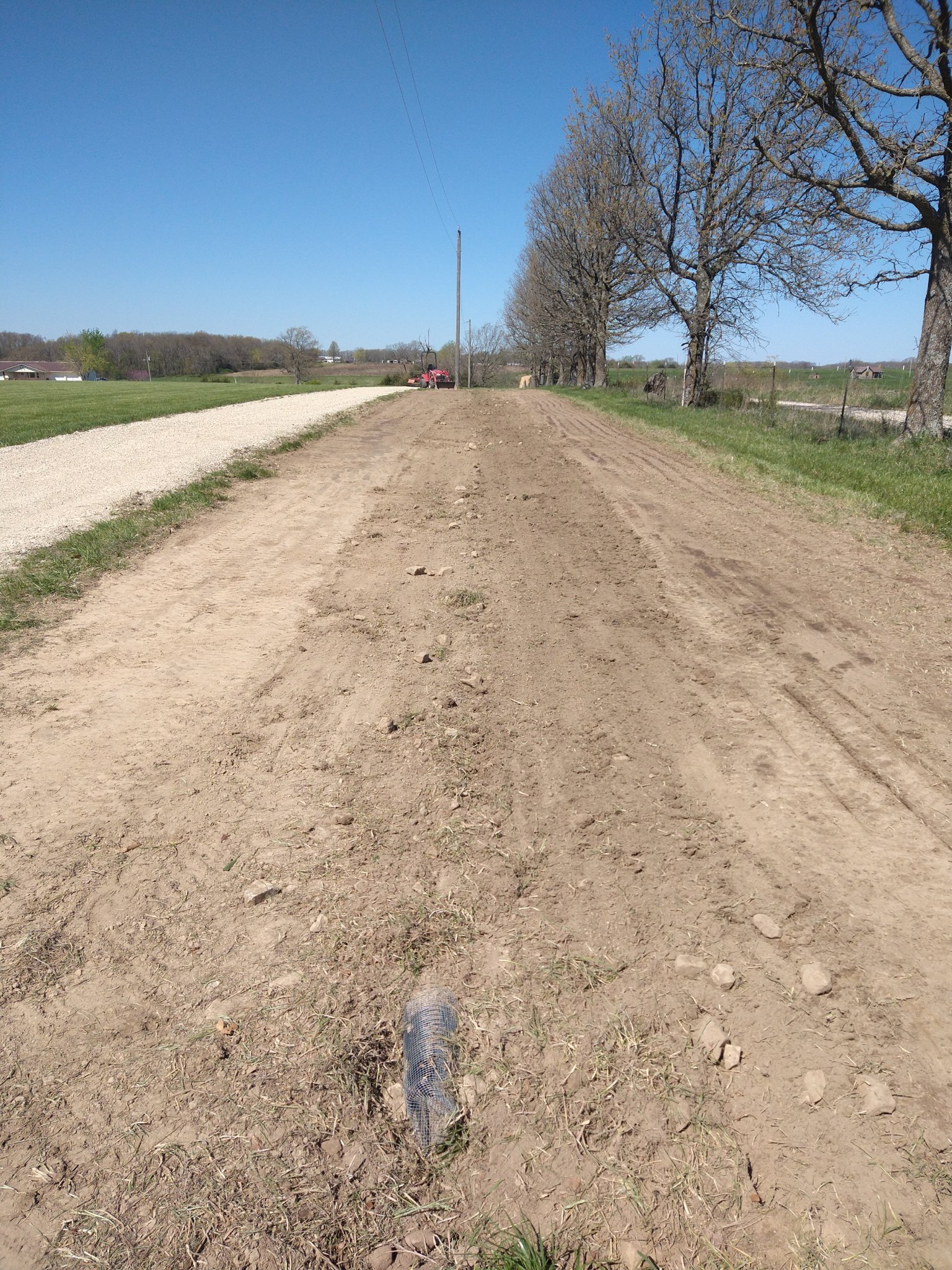

I originally dug the ditch with my backhoe, and bucket, down near the utility pole it's over 2.5' deep, and the top of the rise ... I wanted to make it more "mowable" with a bigger tractor, as it was quite steep ... I scraped off the sides, and covered up the piping ...

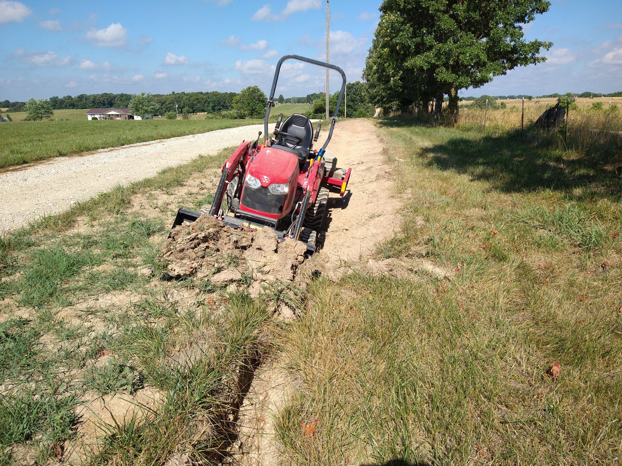

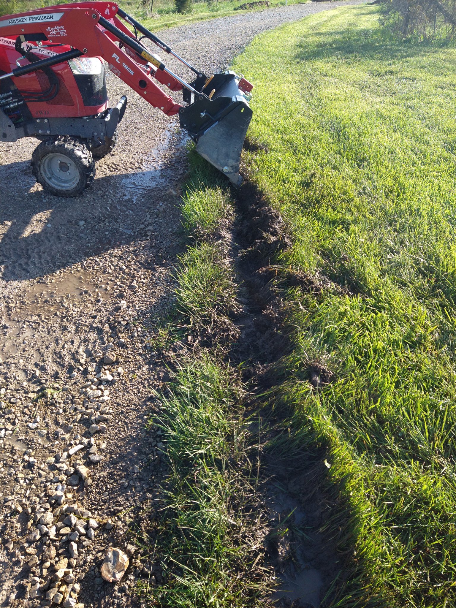

If you don't mind above ground like a swale ... Use the middle buster to loosen up the soil, and if you can start the ditch with clearing out the loosened soil with your bucket hitting it sideways at first ... Kinda like this, I was trying to make a tiny ditch, and didn't have my 6'' BH bucket yet ...
Once you have enough to then drive into the ditch with your rear axle now off camber, you can scoop it out but switching right and left side tires in the ditch ...
