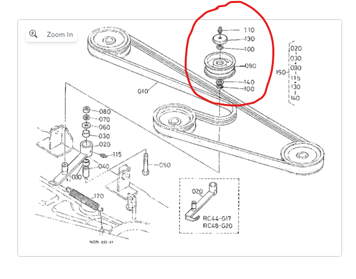

S straytcat New member Equipment Kubota g1800s lawn tractor Jan 15, 2025 2 0 1 Minnesota Today at 10:42 AM #1 any suggestions on removing and replacing a pto idler pulley bearing? It's stuck solid
85Hokie Moderator Staff member Lifetime Member Equipment BX-25D ,PTB. Under Armor, '90&'92-B7100HST's, '06 BX1850 FEL Jul 13, 2013 11,009 2,869 113 Bedford - VA Today at 10:49 AM #2 have you pulled part #100? the C clip?
N nbryan Well-known member Equipment B2650 BH77 LA534 54" ssqa Forks B2782B BB1560 Woods M5-4 MaxxHaul 50039 Jan 3, 2019 1,326 851 113 Hadashville, Manitoba, Canada Today at 11:02 AM #3 Is the pulley frozen onto the idler arm pin? Or is the pulley off, and you're trying to replace the bearing inside the pulley? I don't know your machine, but the last worn out idler pulley I fixed, the replacement pulley and bearing came as a unit.
