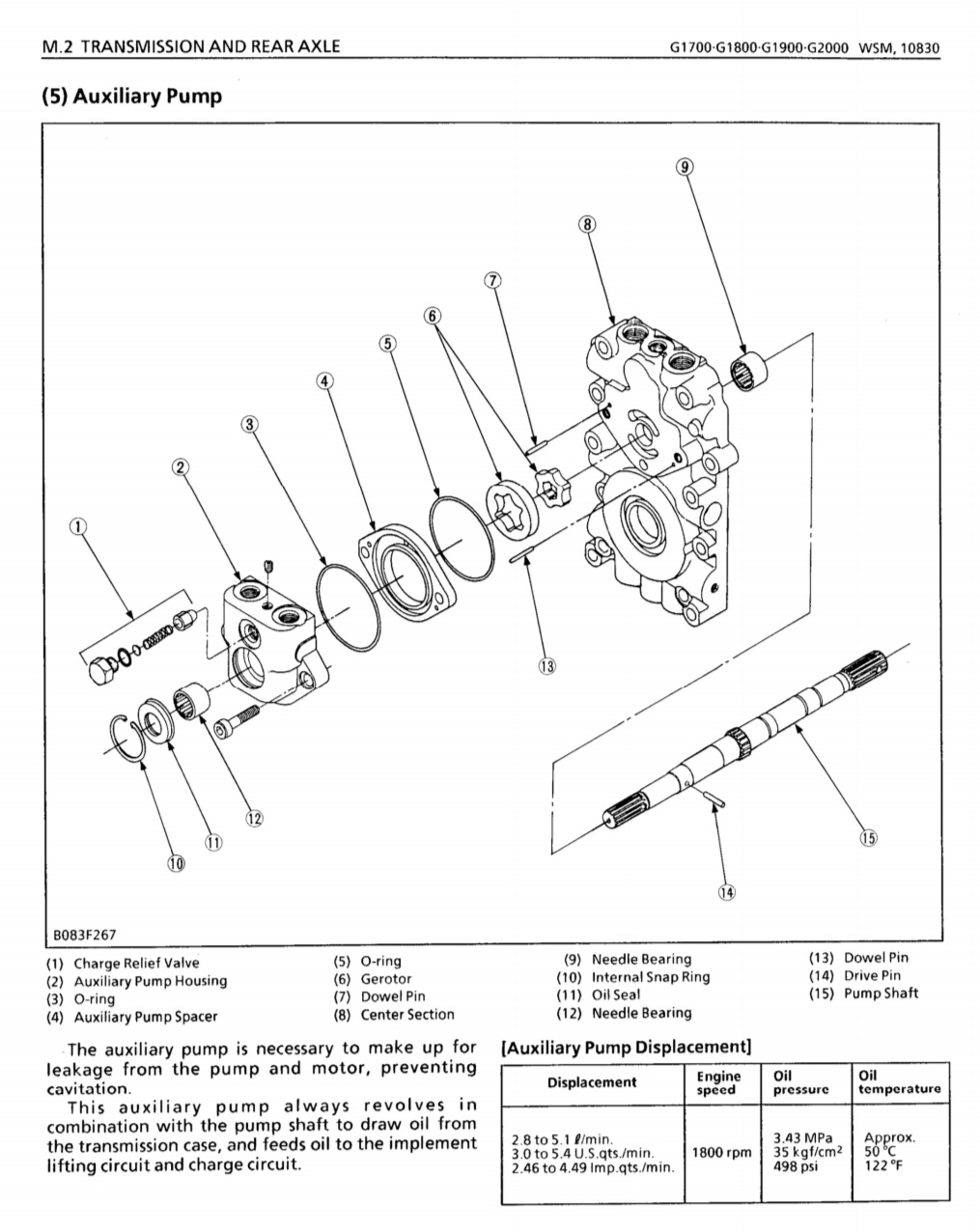

are there hydraulic pumps available where the shaft being driven comes out the other side? Could be female spline as well.
I looked for "hydraulic pump dual shaft" or "hydraulic pump through shaft" but very little came up. Found a few PTO pumps but their speed was too slow. So what are those pumps being called?
Or can it be successful drilling a hole in the rear lid, adding a seal and bringing the shaft through?

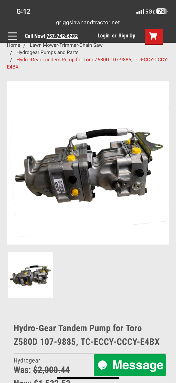

Or I thought of buing a dual pump and removing the second pump section assuming there is a seal between the two hydraulic sections.
