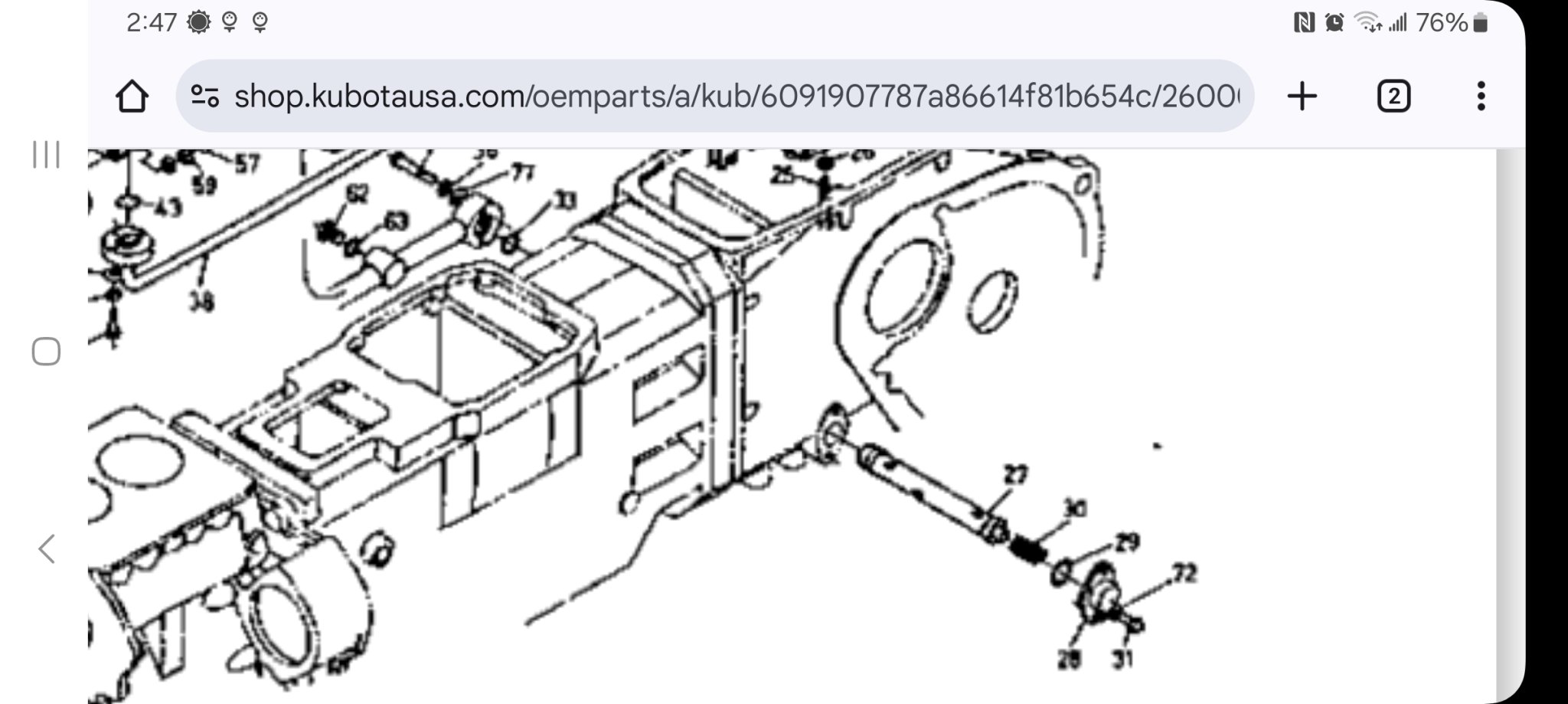

Well i was just going to say that there is no filter on the pick up tube its just a flange mount but just ahead of the flange mount the pipe has a bulbus section what is that for is it a tap or something i will search for filter housing as soon as i get outside this afternoon Mike
9,795
5,167
Item #27 is the screen/filter.

Well i found the filter it was not pretty lot of small metal grindings all over it think it was restricting the flow i tried to clean it but ater a wash and blow i could not see light through it so i will try to find a new one at Kubota dealers does anyone have a part number for it Bet i cannot find one on amazon Mike
