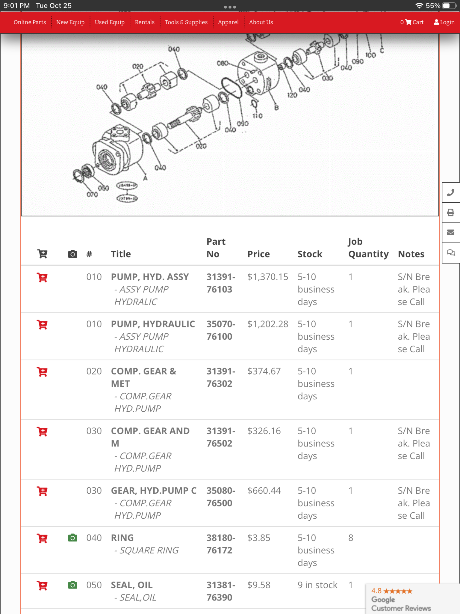

Pulled pump, removed seal. Real PIA cleaning out the groves. Is there any advise is pressing the new seal in so that it seats properly below where snap ring goes?

You can use a deep well socket (slightly smaller than the outer diameter of the seal) and a very small hammer. Shouldn’t take much force at all.

Well found what the issue was that was making seal installation difficult. When I removed the old seal. It came apart on a horizontal plan, leaving the internal metal of the seal in place and after digging out the last of the seal with a pick, the metal case popped out and installing the new seal was a cinch.
