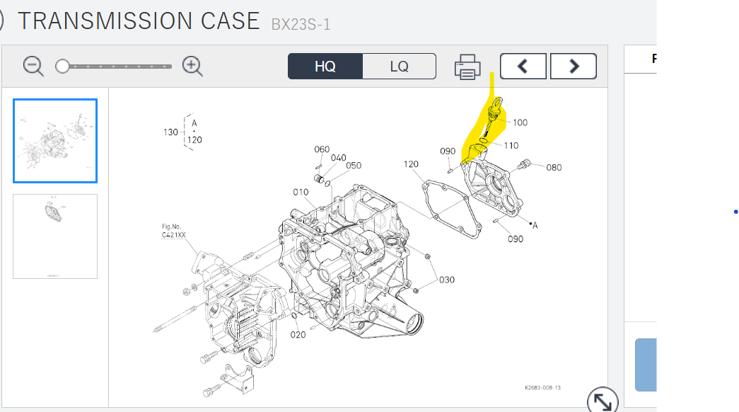

In addition, where do you fill and/or look for hydraulic levels .

As for as location of fill and check. It looks like the rear of the tractor and I do see an orange pull ring there.
