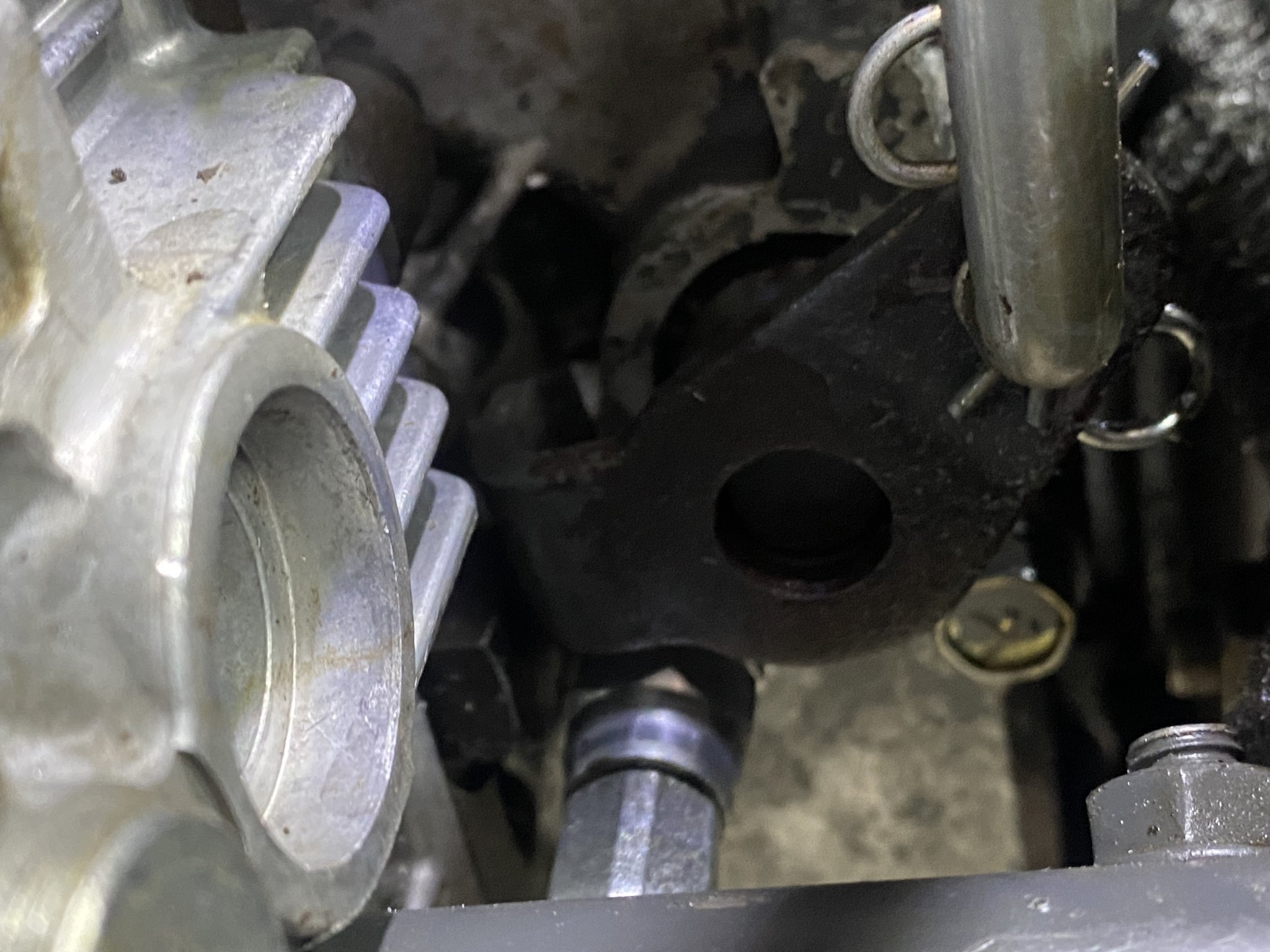

I have a leak at the PTO selector. It looks to be a tight area for the fix.
Just remove selector linkage and bracket and the clip? Or is it more difficult? Thanks.

You're only going to be able to get to half of the issue from the outside.

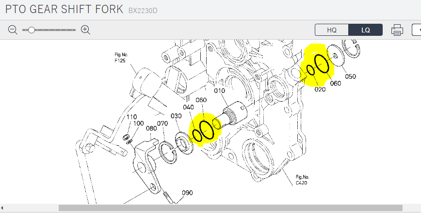

Thanks for the diagram.
I would take it apart, as there is a high possibility that you can get to the inner O-rings from the outside or the inner O-rings simply seal the interior PTO function section of the unit and does not effect the exterior sealing.
