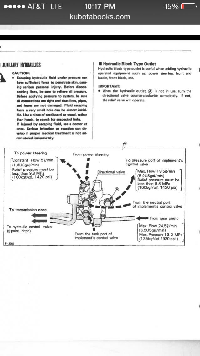

Someone help me out I have a b8200 hst planning to build a full hydraulic plow setup for it I will be adding a prince 2 spool open center valve. My 8200 has the pb block by the right floorboard and I know where the pressure and tank(return line) goes but what in the world is this n(neutral) port I can find no info anywhere about it. My best guess is it goes from the power beyond port of the valve to the neutral port which feeds the 3pt allowing the 3 point to be used simultaneously with a loader but that's a guess.
I need confirmation of how to hook this up so I don't damage anything
Thank you

Great info sir!! So in summary to hook a 2 spool open center valve up I would from the hydraulic block on the tractor run the pressure line to the pressure port of my valve. Run the tank line to the tank port on the valve and lastly the neutral port on the hydraulic block would be connected to power beyond port of my valve?
Just want to be positive on this as a mistake could be costly the rest of the hydraulics I have no trouble figuring out
Also any idea what threads I will need to tap into that block thinking British standard pipe thread 3/8"
