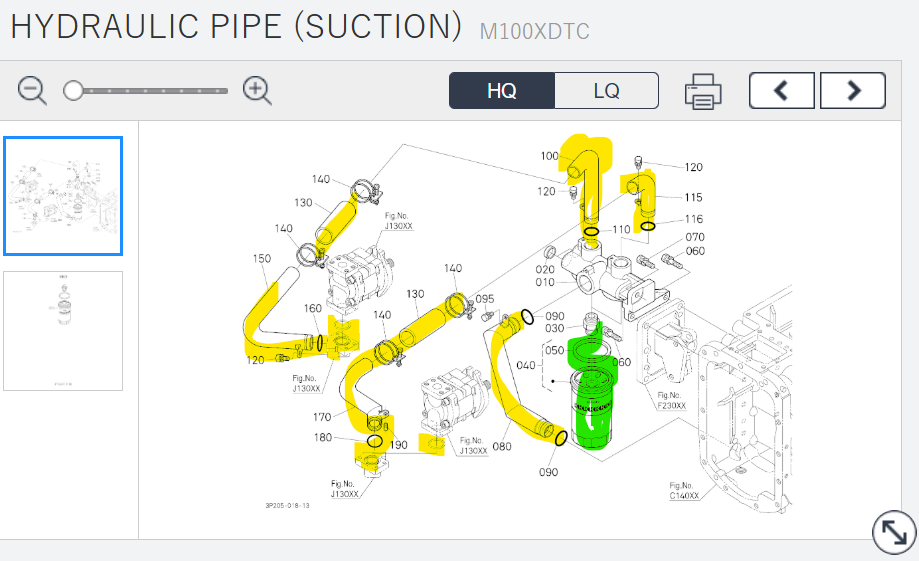

Here is the breather for the hydraulic system (green).
Check it, and also check the plug and fitting in front of it. (yellow)
