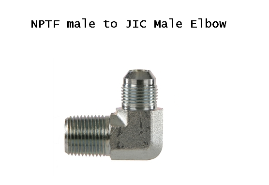

The tools are fine for the small fittings used on your tractor. I don't think you will find many JIC (aka AN) fittings on your cars. I have never encountered one on any of mine. A few examples of the many different JIC hydraulic fittings below

Yes, JIC fittings are used in aftermarket performance parts. I actually have some on the fuel line on my 1951 Ford 8N. I have never come across one as OEM equipment.
AN is an aerospace standard that is very similar to JIC. Most of the (overpriced) fittings sold to the automotive market as AN are actually JIC. The differences between AN and JIC are:
  1. AN has a class 3 thread fit while JIC is class 2
  2. AN threads have a round (UNJ) root while JIC has a flat (UN) root
  3. AN has a material and manufacturing certification.
If you think you are getting a real AN fitting ask the seller for a cert.
