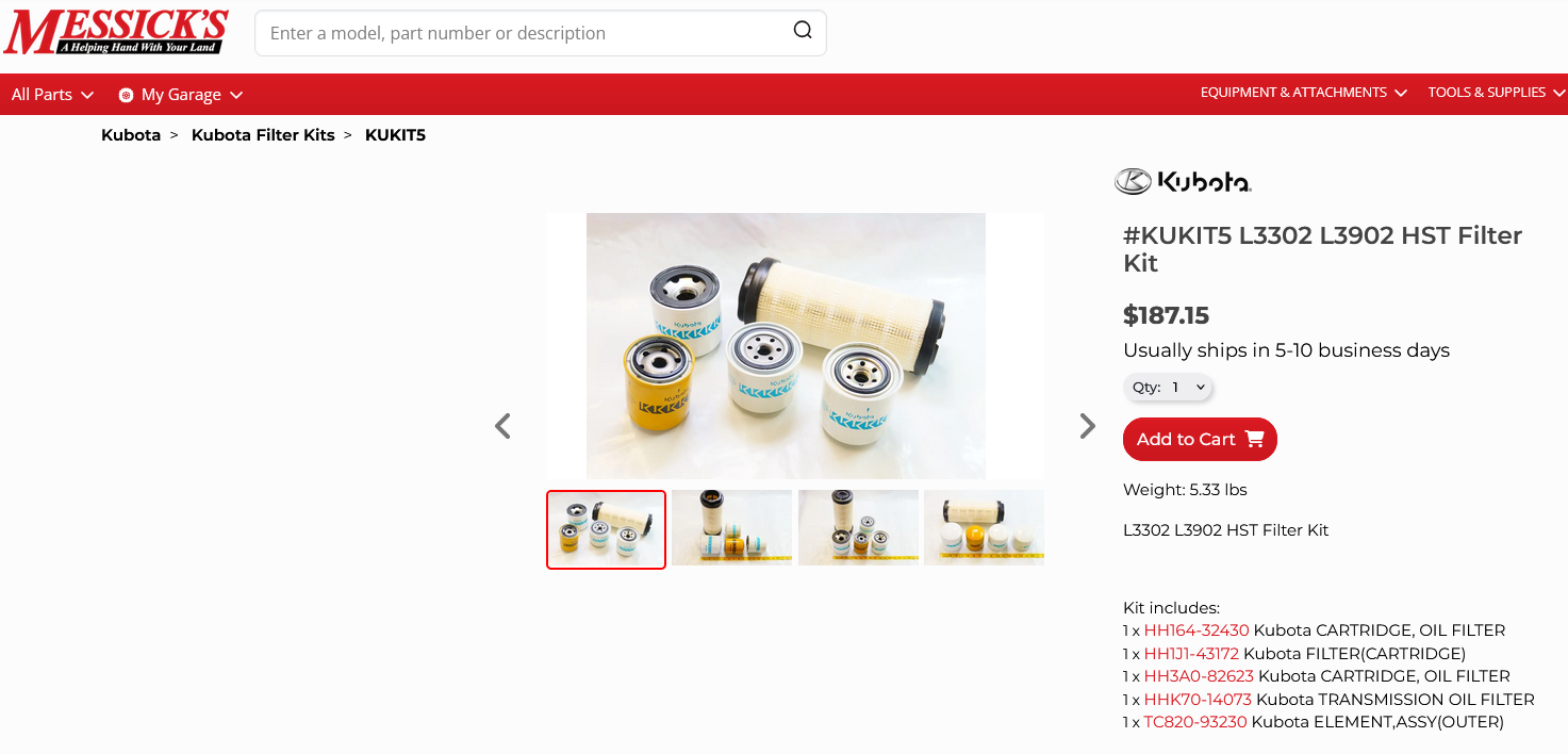

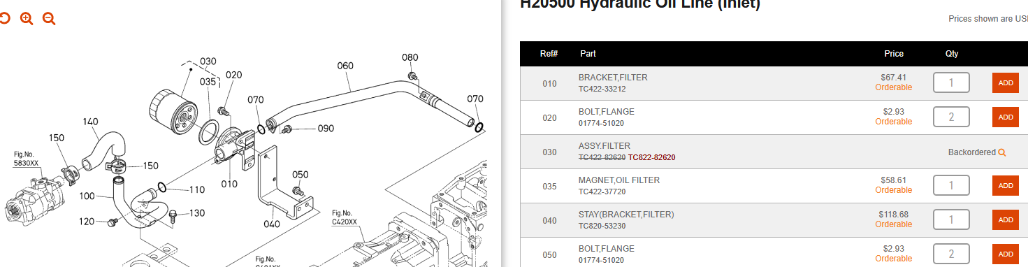

So now I am really confused, I called Coleman Equipment and then the dealer that sold me the tractor.
Both said that TC422-82620 was superseded by TC822-82620 and TC822-82620 was
superseded by HH3A0-82623. The Kubota parts web site does not show this.
What the heck?
Edit: Messicks shows HH3A0-82623 as the correct filter also.
