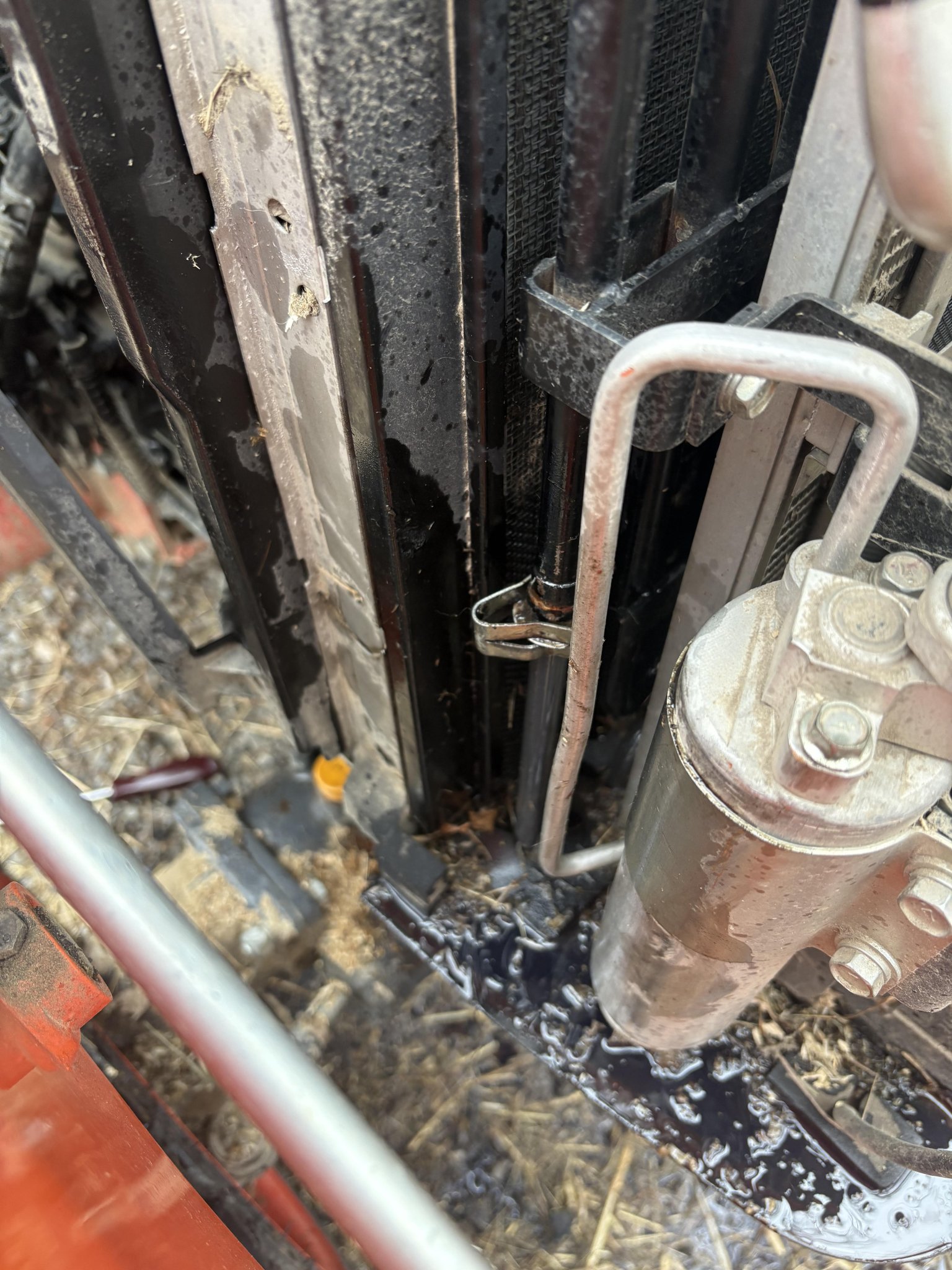

I recently aquired a b2650 hydrostatic with a property I purchased. I noticed it did not have any hydro fluid. I filled it and when I started it, it began leaking profusely from a clip by the radiator. The clip connecting the lines is bent and will not seat properly on one side. What is the name of this clip/clamp? I cannot find a picture of it anywhere to figure out what I need to buy. unnamed.jpg

That's a slip joint with an o-ring 030. That clip 040 holds it together. Maybe just needs cleaning up and a new o-ring.
