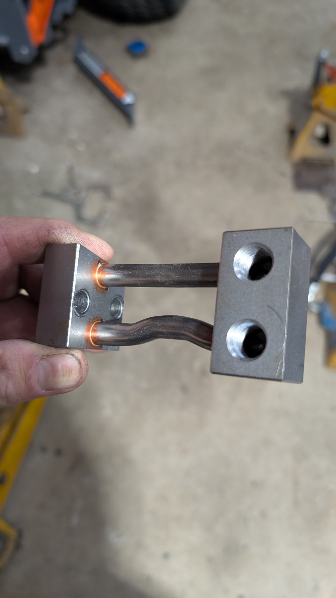

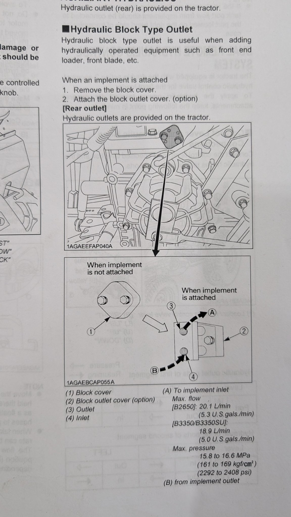

Searching for some guidance about using a hydraulic block outlet to operate an aftermarket 3pt hitch Backhoe. The backhoe comes ready to run off the tractor hydraulics and only requires 5gpm to operate. My B3350 manual list this hydraulic block outlet and I'm wondering if it could be used to supply the hydraulic power to the BH. I understand it would need to be looped together when the BH is not connected. Any suggestions?

Yes it can be used for that purpose, IF you can get the required add on replacement block to connect to. And yes you will need a loop of hoses when backhoe is removed (or swap back to the original cover.)
Added on edit: you can have a block machined to use if the new block is not available

Thanks. I was hoping it would work as opposed to setting up a PTO pump and reservoir system. I already have the hydraulic block outlet. Just need to get the hoses and connectors.
Hook it up and go. When digging with the hoe the 3pt lever/valve MUST be kept in the neutral position.
