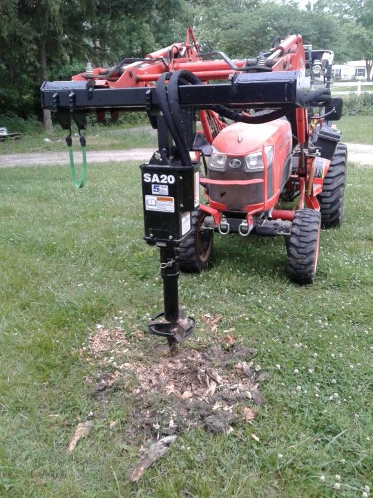

Have the medium flow SA20, bought from Kubota dealer that also sells construction equipment (stocks such toys).
slower than 3pt auger, way faster than hand digging them.
Drilled about 2 dozen holes, don't use down pressure, it lifts the front axle and tractor will pivot right or left. Takes time to reposition auger to finish hole. When I hit a tree root the tractor rocks back & forth. Pop FEL out of float until rocking stops, then slowly lower auger. I would auger up to the gearbox the use a garden hoe to pull soil away from hole before removing auger. Auger is loaded with soil and doesn't spin fast enough to fling it off like a 3pt unit, falls off wen horizontal.
found a tree plane for my stump removal needs
after buying the sa20 had some problems reconnecting auger & storing it

How does the stump planer fair against an occasional rock?

haven't hit one yet, blades can be sharpened/replaced
Hi, Are you running a stump planer on the sa20 and a BX? Planer Diameter? Rpm? It has enough torque?
I'm curious as I have a low flow (no name) auger on my LX2610 and am wondering if a 10" planer would be effective for homeowner/occasional usage.
Any specifics would be helpful and appreciated!

Using B2650, predecessor to the LX2610. Thought a stump planner would make LP SA20 more useful. Low flow pump powering med flow motor, runs slower, more torque???
Pay attention to cutting sequence, ok for home owner use, not the best for commercial work
