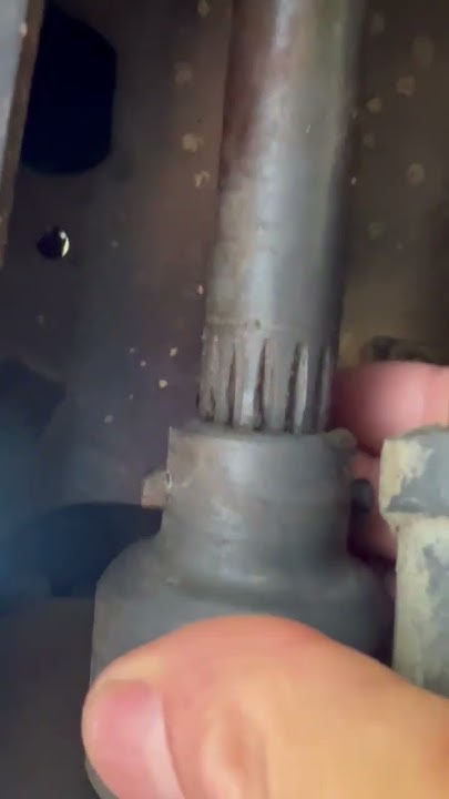

Thanks! Changed fluid and filters to Kubota spec including the use of super UDT2 this am and no change in the noise. The drive shaft seems loose/rattly but I don't have anything to compare it to.
Does the amount of movement/noise in the video below seem out of spec? If so, how hard is this thing to change out?
