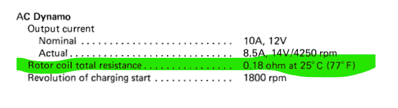

I have a B7200d and replaced the dynamo (P/N- 15531-64013). All is working great. I disassembled the old Dynamo – P/N- 15531-64013. The housing had caked on dirt on the housing, The copper wiring looks good. Bearings all feel good. How can I test the winding to see if the winding is good. With the Dynamo off the tractor. Using a multimeter, what should the ohms be? Thanks

Touching the leads together I have 0.1 and when I touch the Dynamo wire I get 0.3, so I have a 0.2 reading
Thanks for the input.
