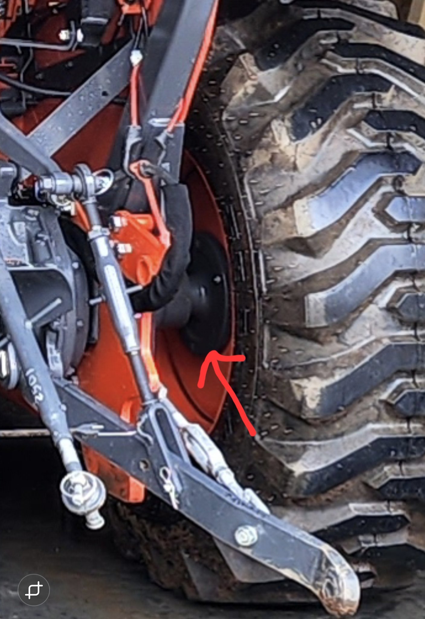

how to tell if the dealer put on the 3.6" offset on the rears

It looks to me that there is a spacer in there, and it looks wider than mine that are the OEM spacers.
If there is no spacer, the inside of the rear tire will be very close to the fender ... about an inch or a bit more.

Do you see 3.6" offset tire wheel spacers. If the Kubota website lists as an option, "Rear 15-19.5 R4 Titan Trac Loader 3.6" offset", shouldn't there be spacers on the rear of this tractor? Or Is the rim offset, so no need for spacers? Thanks. View attachment 153434
The 3.6 is the wheel offset,not a spacer

Thanks for the info. I'm under the impression the 3.6 inch offset relates to the dish rim as we call it in car racing. That dish acts as the offset by pushing the tire out because the rim is deep. Thoughts?
