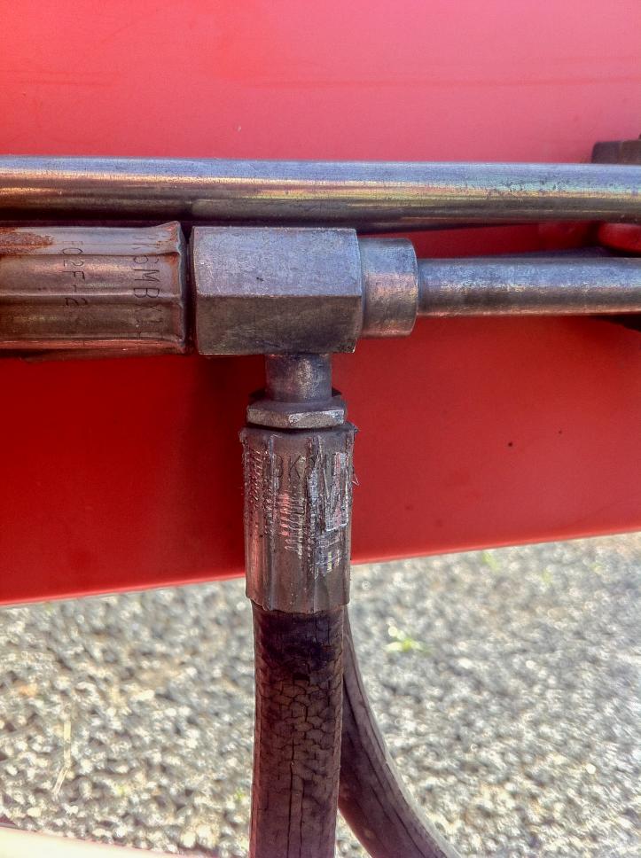

Anybody have some advice on getting this hose off? GB260 front end loader on our B3600 - the nut on the T is cast onto the T, so I'm guessing it's just there to hold the T while you spin the hose off? Obviously been going at the hose here, but not making any progress. Need to replace the hose due to a leak at the other end.
14 years of living outside, and I'm sure this is the first of many (all) of the hoses that will need replacing.
Any advice or suggestions appreciated!

Sorry to say but that is a one piece unit not meant to come apart. You will have to replace the hoses and pipe as a unit or better yet convert it to hoses with tee fitting and eliminate the steel pipe / hose unit all together.

Thanks for the Sunday reply. At least I can stop banging my head (and knuckles) on this one. I guess into the shop she goes.

WOW, yes very poor design for repair.
That is a crimped on design that will need to be replaced with a Spud, or pipe fitting.
I would bite the bullet and do all of them at the same time!
