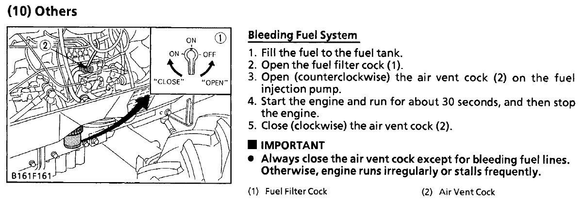

How to remove air from L4310 fuel system
Bee-Positive
BX1880, FEL, Tooth Bar, MMM, QH, Ballast Box
Nov 16, 2022
246
248
Amsterdam, NY
Page G-24 of the WSM
chim
L4240HSTC with FEL, Ford 1210
Jan 19, 2013
2,565
1,803
Near Lancaster, PA, USA
That is the procedure I followed yesterday. Worked perfectly. The L4240 started immediately and didn't even run rough.
