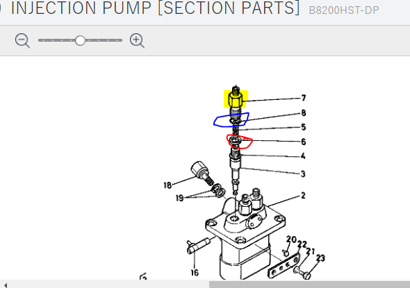

That is a delivery valve on the pump. There are some gaskets and o-rings involved in sealing it.
See the illustrated parts list for the engine at:

DO NOT USE any sealing compounds or tapes, you will ruin the pump!
On that model you can do it if your very careful.
Clean the top of injection pump with brake parts cleaner and let it dry!
Hold the delivery holder (yellow) and remove three line nut, you will need to both ends, to get it out of the way DO NOT bend the lines.
Loosen the delivery valve holder (yellow) and remove ONLY the delivery valve holder and the oring and the spring, then you will need to fish out the copper sealing washer, replace the copper sealing washer ( where the leak really starts) the O-ring and tighten them to spec in the WSM, (aka service manual).
Replace the fuel lines leaving them loose at the injector side to bleed the air out of the lines.
