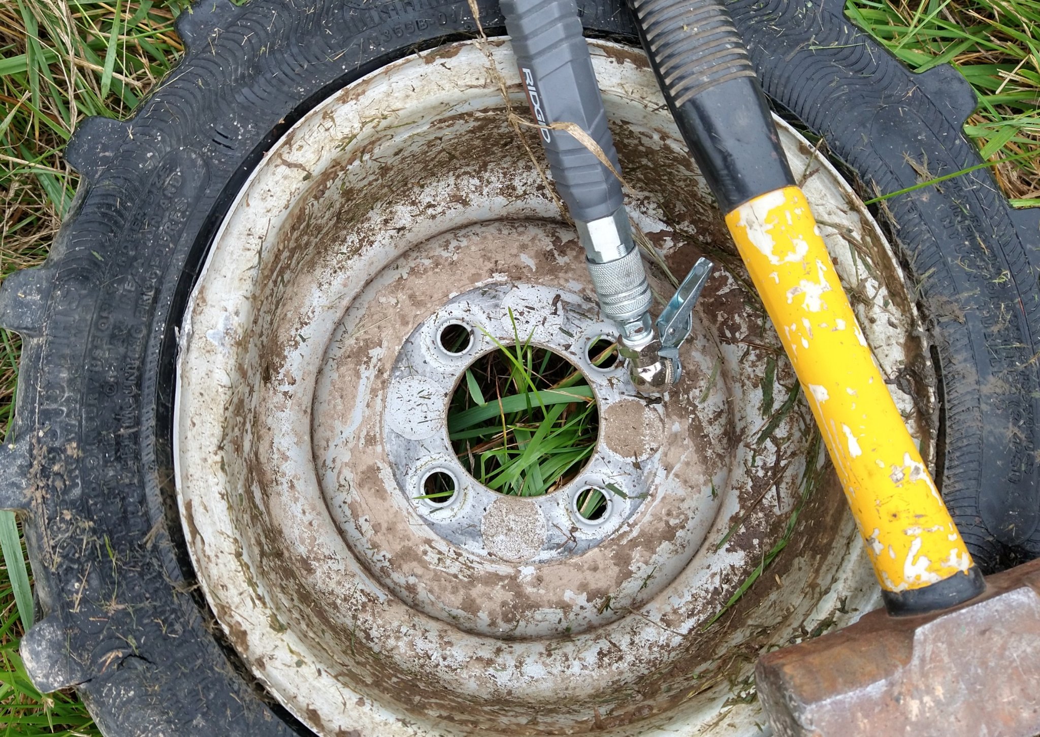

How is the best way to remove the front wheel/tire when repairing a flat?
wendol
L3800 HST
Feb 5, 2014
197
41
81
North Tx
I called out a mobil service to repair a flat on the front wheel/tire, and was shocked when he took out his sledge hammer and began to beat (with major force) on the inside of the wheel/tire to remove it. This process took about four attempts. I could only wonder what damage could occur to the steering linkage, and any related parts.
Which brings me to the question, what are the options when it comes to removing the front tire/wheel. I noticed the wheel has square slots in it, which made me wonder if there is some sort of puller that could be used.
Thanks for any and all thoughts!!

When I had to remove mine they came off without having to beat on anything. I put anti-seize on the mating services to prevent any problems in the future.

You saw the standard "puller" in action.

I just rebuilt my brakes/wheels and yeah, they can rust tight, and yeah, initially I palm-fisted them, then beat them with a sledge. Didn't work.
I then removed the lug nuts then put 3 back on to finger-snug then backed them off 1 full turn and dropped the the jack fast, which worked for 2 wheels. The next option for those still stuck was drive around slowly with a wrench in the truck, when I heard a pop I'd go tighten the lugs and drive back, then pull the wheel.
After replacing the rotors and plating the rims they pop off just fine.

Best means to break the tire bead from the rim is a slide hammer.
Other means sometimes work but a slide hammer always works if one knows how to use it.
ANY mobile tire "professional" should have a slide hammer on his truck. Those who do not are lacking, in my opinion.
Additionally, anyone using a sledge hammer to break the bead on the front tire of a small tractor should first remove the tire/wheel and do so with the tire/wheel on the ground. Failure to do so is anything but "professional."

If you're talking about removing the tire from the rim instead of the wheel from the vehicle a shop would use a tire machine and a mobile tire guy would install your spare.
Without a tire machine I'd use Quick Clamps, and/or plastic shims and tire irons.
Usually using a palm hit will break a rim free, if not a sledge hammer is fast and pretty safe, etc. A slide hammer might chip the rim coating, might not, it depends, but it does sound like a good tool to use if it has jaws designed for the task.

When a wheel is seized on the hub you loosen the nuts / bolts slightly and then you drive the vehicle, brake hard or go around in circles. It will come loose without any parts of the axle ever seeing higher loads than what they are designed for.
I always put a slight (!) coat of ceramic paste or corrosion protection wax on the hub centre where the rim sits to prevent the rim from seizing.
Did he repair the paint damage on the rim he did with his hammer? Otherwise the next leak is pre-programmed when the edge starts rusting.

I like your method of loosen the lug nuts, drive, etc.
Also reminds me I need to touch up the rim.......great advice.......thanks!!

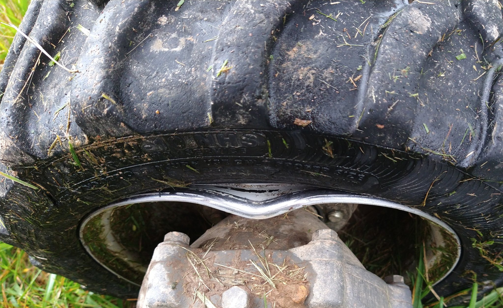

I can say that with weight, speed, and low air pressure that a steel wheel can be bent on a rock!
And ... A hammer can straighten it out "good enough" to hold air!
But just a wack to knock it loose shouldn't hurt anything ...

Looking for a "Wheel Puller" I haven't seen one other than the Rimwit. (sledge beating by someone not inclined for it to work are also in the video) Maybe someone can link one up.
I used a sledge hammer on the rubber tires, then a block of wood against the rim with a sledge, and when those didn't work and dropping the vehicle didn't work I drove it back and forth a bit (like 20 feet, not around the block, though I've done that on badly rusted rims). I've not had issue getting off aluminum rims or really anything but rusted steel-on-steel.
@Shawn T. W : How hard was it to beat that back into shape???

Not that hard at all, it's the front rim on my little SCUT ... The hammer as shown is either 2 or 3 Lbs ...
