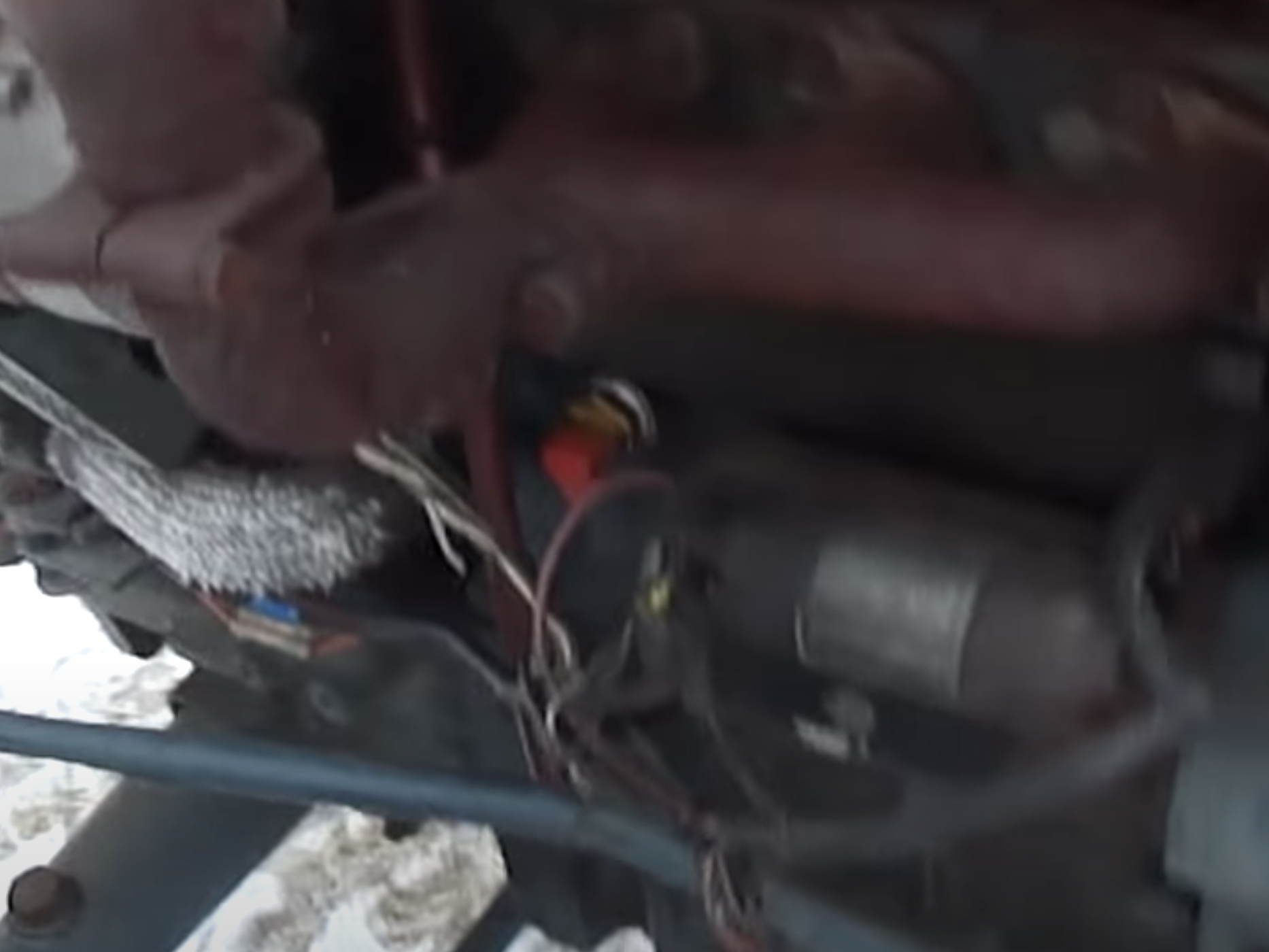

I found one video online where you glimpse the owner’s block heater and it was installed in a freeze plug hole on the left side of the engine in front of the starter motor.

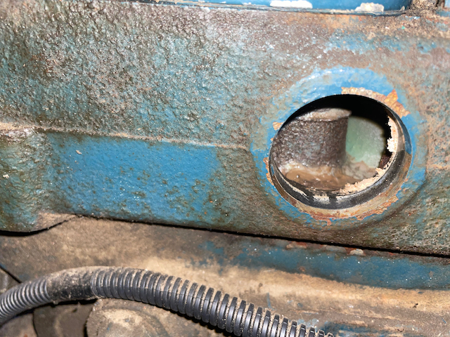

When the heater came, I drained the antifreeze, popped the plug and found there was essentially no clearance for the heater element.
The cylinder wall is right next to the opening.

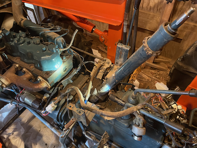

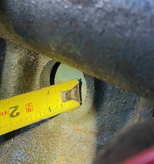

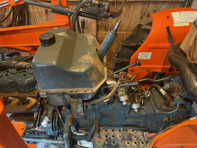

To get in there, I’d need to pull off the instrument console, the steering wheel, the fuel tank, and the sheet metal fuel tank mount (and heat shield?). Once I did that, there was the freeze plug.

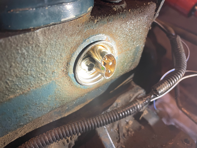

Once I knocked the plug out, it was obvious that there was only one way the curved element would fit in.

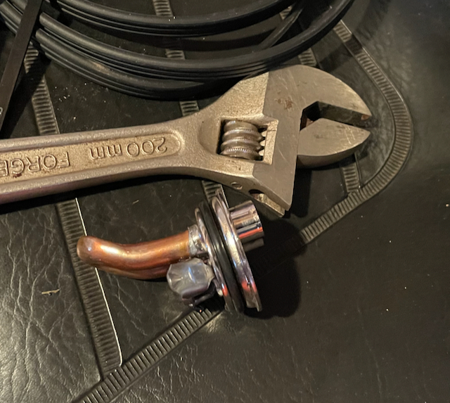

Here’s the element.
The angled element slides in toward the right. It fit very nicely.

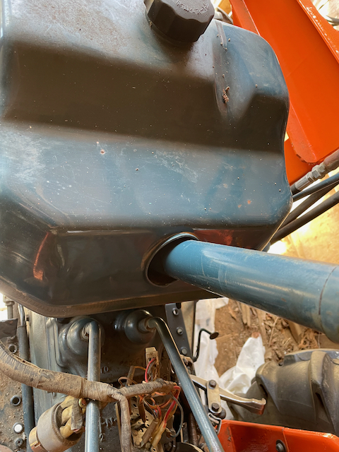

However, the plug prevented the fuel tank mounting bracket from going as far forward as it should, and the tank rubbed up against the steering column.

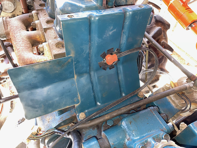

So, I used a hole saw and cut an oversized hole in the mounting bracket, sanded the edges, and lined the hole with thick rubber tape to minimize vibration wear, and installed the bracket again. The plug was inserted after the bracket was installed.

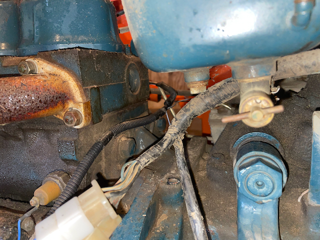

It’s very tight, but I think it’ll be fine. My only worry is that there’s going to be a fair amount of heat buildup in that area during the summer months particularly, and I don’t know how the wire will fare long term.
