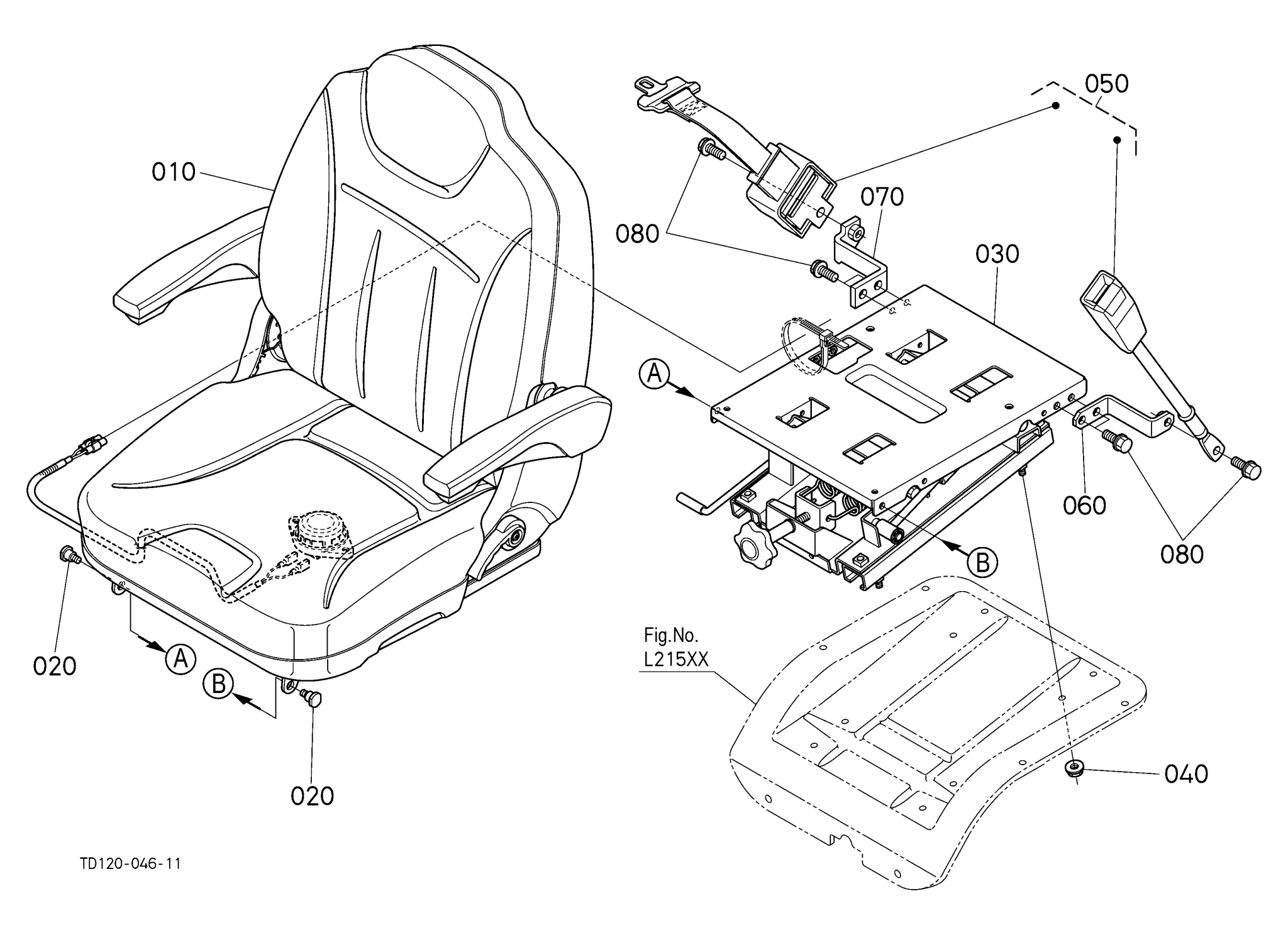

curious, so I looked ....
In the seat ,you can see a 'disk'..that's the seat sensor.....with wires leading out front, then to right side.
when a weight presses down on it, switch works....

That's a handy diagram, is there a service manual or something available I can download?
Looks like a parts diagram - - https://apps.kubotausa.com/illustrated-parts/
Try here for Operator and/or Workshop Manuals (WSM). Not sure if a WSM would cover all models in the Lxx40 series, or individual models.
