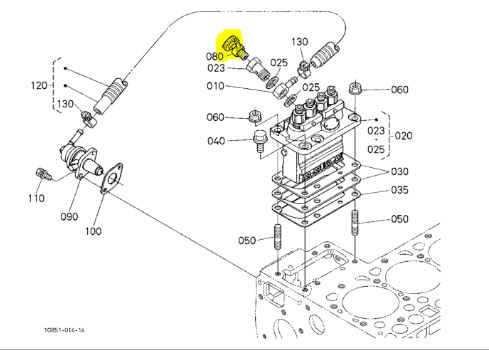

If you've already sucked air into the injection pump your most likely going to need to crack the lines at the injectors and bleed the air out of them.
In the future leave the fuel canister loose turn the fuel on bleed out the air and tighten, and also open the jet start (IN YELLOW) valve to bleed off any air in the lines.

Wolfman, always wondered what that knob was called. Never knew what to call it but always glad I had one to use. May be luck but I've never had to crack a injector line loose to get mine to start. Never understood why all Kubotas don't have one.
