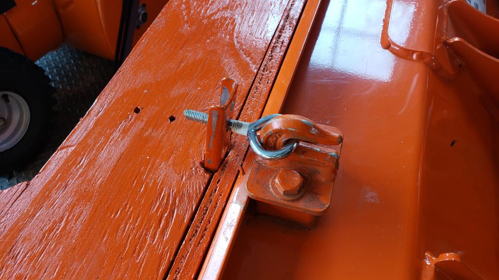

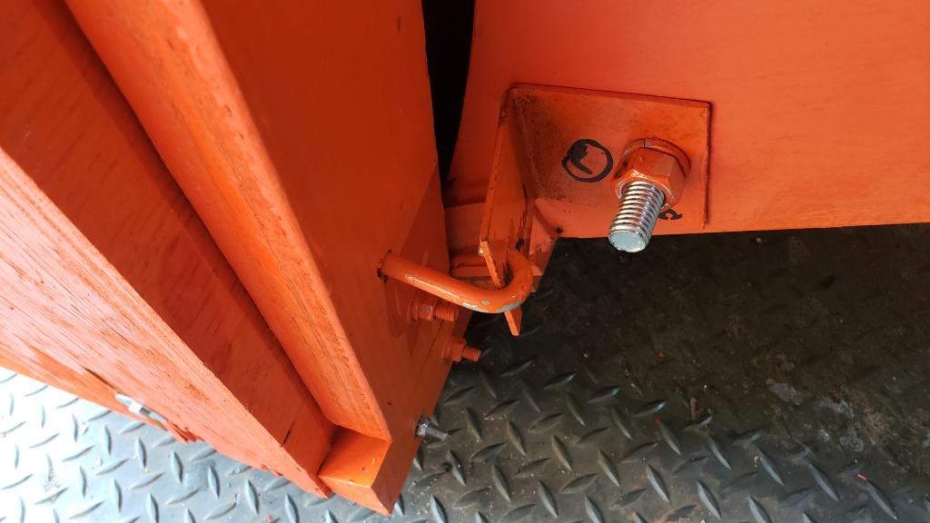

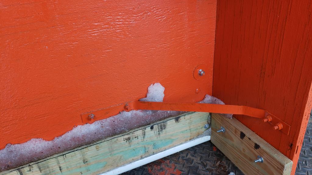

So I made this home made Snow pusher to attach to the bucket of my BX1880. It comes on and off pretty easy in about 5 Min. I used 3/4 pressure treated plywood for most. 2x4's for sides and braces. 5/4 decking boards for bottom edge, and PVC cut on cutting edge. A couple of trips to Hardware store for angle braces, I nut and bolted 90% with lock nuts, and tread locker, with washers. It dosn't cut the ice, I didn't plan on it for that, I have a Rear Blade for that. It simply pushes the piles of snow to end of my driveway. First I used the snow blower, Then used the pusher to push to rear driveway. I was still able to push the snow up on top of a pile. Total cost was may $100. Used once so far, I'll see how it does next storm. Who know's when that will be, it was 52 out today. Next snow storm I will try to post a video on You tube.
