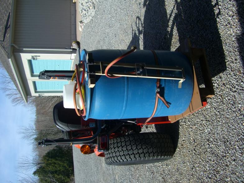

After making my carry all and thinking that a water tank for watering distant plants and spraying fertilizer would be handy, but, not worth the several hundreds of dollar needed to buy one, I set forth on this contraption.
Basically, it is a 55-gallon plastic drum, this one had water soluble RV anti-free in it. I used some 3/4 inch white pipe and mounted an L-shaped pick-up into the tank, a cheap HF 12-volt pump and some garden hose. I used that so I could couple in a hand sprayer as well as the single point broadcast sprayer. The sprayer mount is detachable and the sprayer head is a "RainBird" border spray head with a 16-foot spray width.
I will need to reduce the sprayer pressure currently at 50 psi to the more desired 30psi but for the moment it all works.
I used it today to water in some new conifers that were out with long hose distance and thought it much better that many watering cans - aka Gunda Din.
I think all in I have about $40 in the job.
I will be adding a second ratchet strap to nearer the top of the tank when traveling across the grass spraying.
The upside-down ice cream tub is to protect the pump when it is stored outside.

Thats pretty neat, whats the bracket on the drum for :confused:

The bracket is the removable drop to hold the single sprayer head. I was unsure as to what height was best for spraying so I gave myself room to either lower the carrier or raise the spray location.
The drop is not fixed to the drum - obviously but slots into 2 spring button units at the top. I made it from the workings of a donated garden gazebo.
Works well for all I will use it for and that is what I was needing.
If you want any additional info or pictures let me know.
