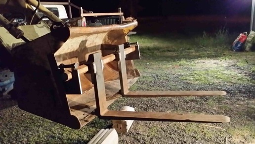

Dave,
Though my sister and brother-in-law have a Kubota of which they are quite fond; sadly, I do not own an "orange tractor." As a result, I am but a temporary visitor to this site. Nevertheless, I expended the time and effort to register in order to post my heart-felt thanks for your willingness to post pictures and share information about your creation.
My son recently ordered some "palletized merchandise" with a shipping weight of about 1200lbs. The delivery company wanted an additional $450 to upgrade the "curbside" drop-off to garage delivery. We thought this rather expensive; however, as it turned out, the shipment was delivered on a 40-foot flatbed -- there was no way it could have navigated his gravel driveway. The $450 was their fee for having to transport a fork-lift that would not be needed for a simple drop-off in the street...
I spent some time casting about for what we might do to enable my Ford 4500 to pick up the goods and avoid the $450 charge. As it turned out, the solution, inspired by your post, cost a significant portion of that sum. Nevertheless, it proved worth it because, when all was said and done, we had another "tool in our kit box" that we would not have gained by simply paying the enhanced delivery fee.
Anyway, I thought I would take a moment to say thank you (!) and to post a picture or three showing the fruits of one exceedingly long weekend. These were taken at 3:30AM. The "package" arrived at 11:00AM the same day and the tractor had no problem handling it. Since my bucket is six feet wide, we chose a 3" hex bar as the top rail for this endeavor.
Enjoy!
