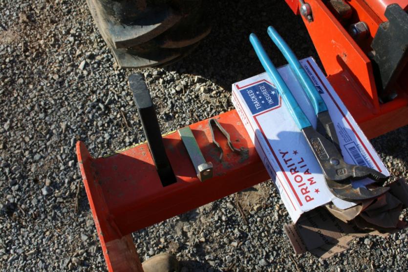

I bought 4 foot box blade that didn't come with keepers for the scarifiers. It's a Hiniker big ox. I can't find anything on the hiniker website. Wondering if anyone has a link to them or a picture. There are a couple of local dealers I can ask on Monday.

I talked to a dealer who didn't know much about box blades. I wasn't successful in finding anything on the Internet but there is a label with an address on it to write for replacement manuals and the manual showed up today. The scarifiers that came with it are wrong and have been bubbasmithed to try to make them work. The notches are in the back and they need to be in the front. The keepers appear to be unique to hiniker.

Hiniker doesn't carry parts for these any more. So off the top of your head what other brands use scarifiers with notches in the front

My Land Pride box blade scarifiers are notched in the front. From the pics I saw of the Hiniker blade they should be very close. Draw up the size of the slot and take it to your friendly Kubota dealer and look at a Land Pride. Or ask him if you can take one with you to see if it fits. I doubt they can be too much different.

I found and bought 4 of the flat style keepers so I think I'm good there.

I have 4 landpride on order. Thanks to all who helped
