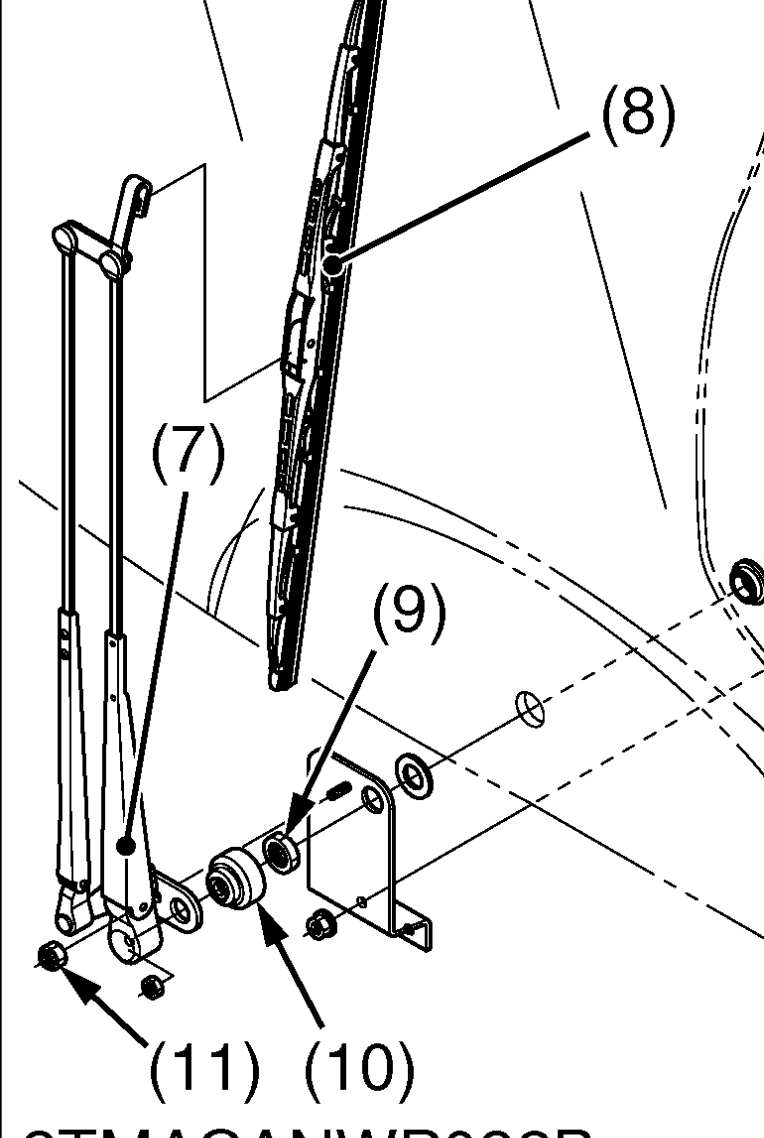

Hey all
I recently had to replace the front windshield on my 2012 Kubota M8540 (cab of course). Since the wiper motor drive goes through a hole in the glass, I had to remove the wiper arm assembly. Ended up needing a wiper arm puller to get it off. NOW - I can't get that thing back on to save me. It even seems like I'm somehow not putting it back on right as things don't fit correctly in my mind. I do have a pic from the service manual showing the exploded view but I'll be damned if can figure out the right way to get it back on.
Anyone have experience or any ideas to help a guy out? :unsure:

What are you not getting about installing it?
In the image you notice 2 studs, one being the actual drive shaft of the wiper motor and the other to anchor the "bracing arm". The problem is that the seals/rubber bushings that go on the driveshaft as well as the fact that the wiper arm only goes on a little way once it engages the teeth of the drive-- that makes it nearly impossible to get the other part of the base plate over the other stud.
I know this is unclear but it's about the single baseplate with the 2 holes for the 2 studs seeming to need to be in 2 different planes rather than on the same one, as it seems in the picture. Maybe I can get an actual photo tomorrow.

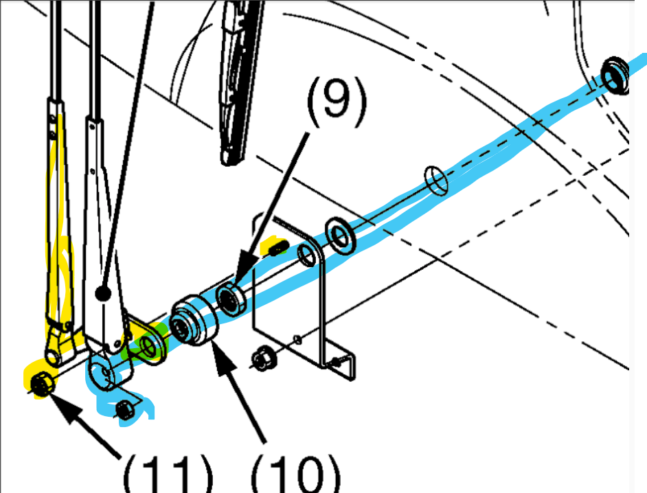

33,849
9,074
You install the parts in yellow first, then you install the parts in blue.
My problem is that the rubber piece (#10) pushes on the mounting plate that is part of both yellow and blue such that getting the plate onto the yellow stud is not possible.
I even separated the yellow arm from the rest of the assembly via the 2 set screws in the image but the issue is with mounting the base plate.

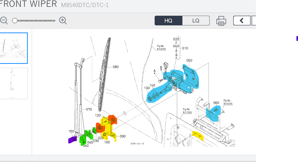

33,849
9,074
Let's try a different approach
Install of of the blue parts.
Install the yellow bracket
Install the orange washer and nut.
Install the green main wiper arm
Install the purple nut.
And post pictures of what your dealing with if you can't get it.

So using your diagram and color coding (nice touch) the blue, orange and yellow components were not removes (by me) unless the glass shop did to install the glass. So they are in
Looks like I’m an idiot for taking the diagram literally. The service manager at Kubota Coeur d’Alene (not my local dealer) said that the arm base goes on first followed by parts 30 and 45, unlike the diagram. DOH. Thanks for helping.
