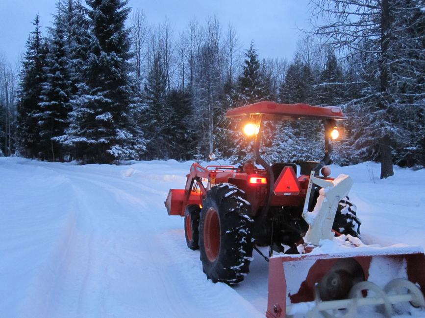

My L3600
With 60" Blower attached

You have a Cat 1 hitch BTW and you can easily handle up to a 66" blower the 72" is a maximum according to the specs.. The little arrow mark on your tach at about 2400 RPM means your PTO is spinning at 540 RPM which should be correct for most rear blowers.. You have a little over 31 HP at the PTO
Biggest concern for using PTO power,,, It stops for nothing, NEVER get out of the seat of the tractor with the PTO running, the little lever on the right side of the seat above the 3Pt lift lever engages the PTO, save wear and tear and engage at idle then rev up to operating speed, before moving the tractor, slow and steady wins the race when blowing snow, going too fast, or bumping snow banks, breaks shear pins, which wastes more time then going slow and steady :p A pic of the blower would really help also or at least the specs...
