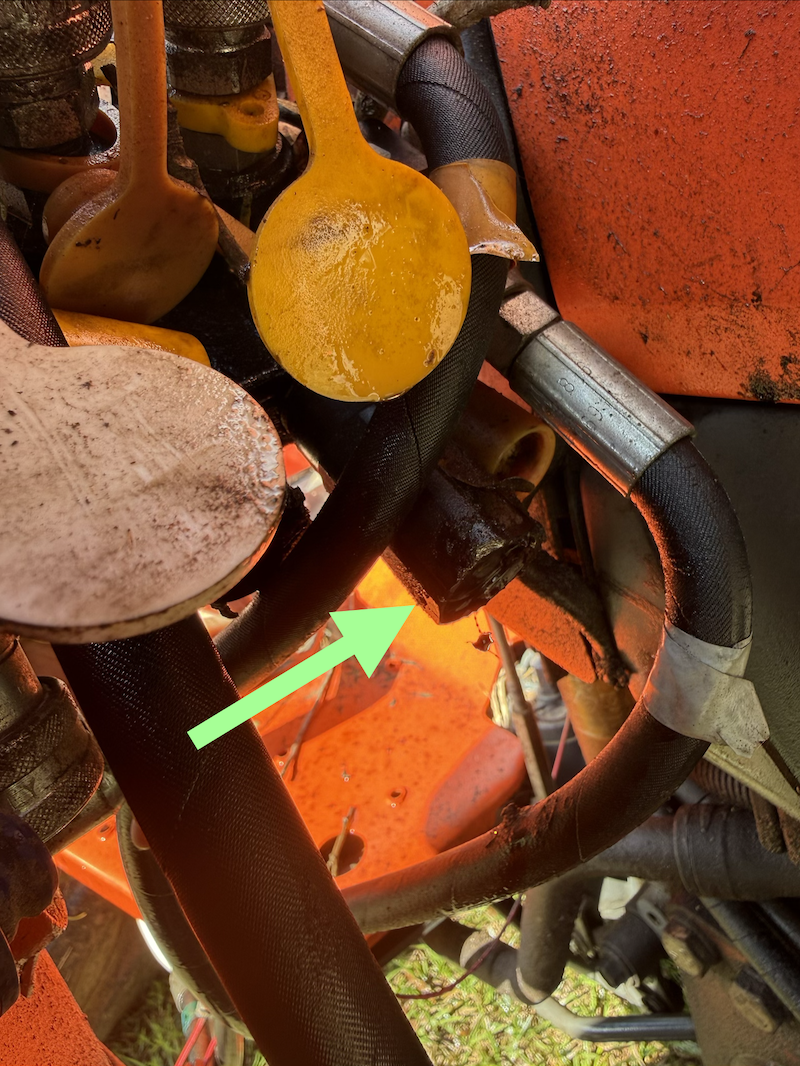

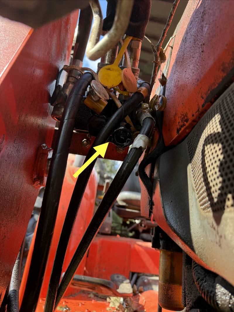

I was moving brush piles today with my grapple when my loader control valve sprang a high pressure leak. I am not handy and not good at repairs, so I'd just as soon take it to the dealer, but I need to figure out how to stop this leak in the meantime so I can get it onto the trailer.
Tractor is an L4701-HST with an LA765 loader. I think the valve block is part number YS027.
Can someone tell me:
a.) What is this part called that's leaking? (it literally looks like the end blew off of this thing)
and
b.) Is there some way to easily cut off the hydraulic fluid to the loader?
Pictures are attached and a short video of the leak is at the link.
Thanks in advance for your help.

There may be a “valve” to divert the pump flow. Follow the hose that enters the FEL power in port (usually labeled with a “P” cast into the valve) down to where it connects to the tractor. There may be a block with three hoses connected to it. There may be a screwdriver slot to turn one way or the other (vertical to horizontal maybe). The operator manual should cover it.
Otherwise you can disconnect the power in line from the valve and bypass the FEL valve by connecting the Power in line to the power beyond line (or connect the power in line to where the power beyond line connects (at the point where the PB line connects to the tractor again).

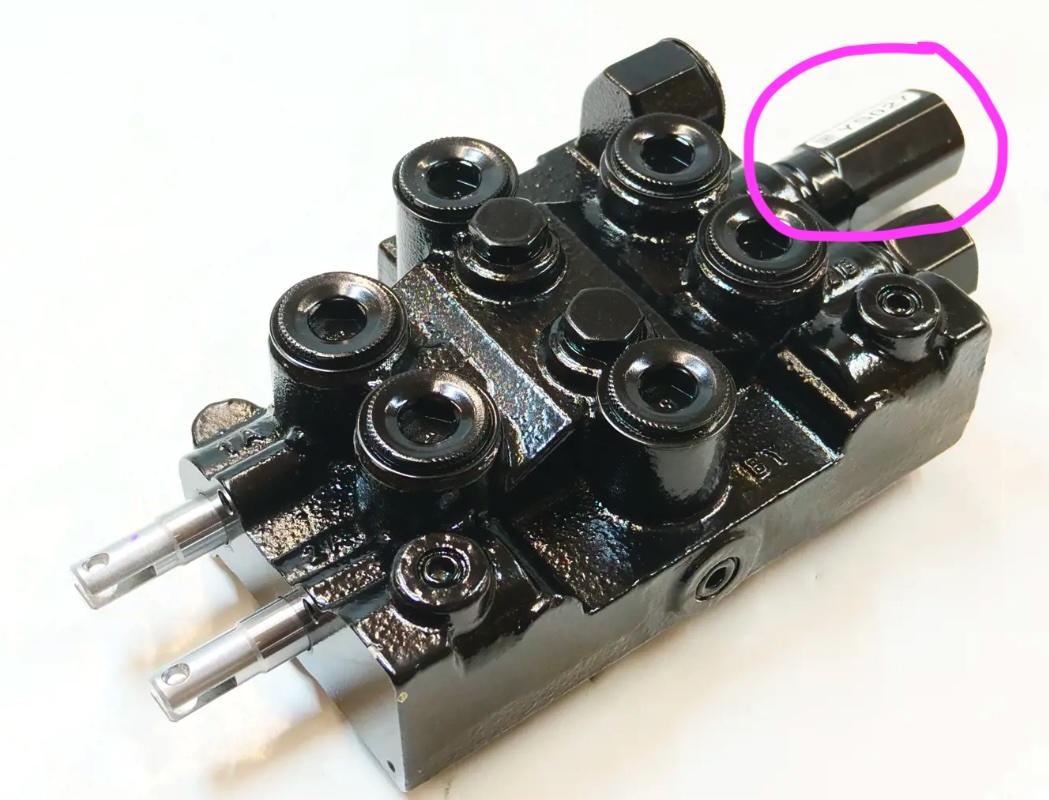

That is the spool positioner cover for the float position on the boom spool.
There should be near zero pressure inside that cover. Do you have a backhoe, rear remotes, or 3rd function on the tractor?

Yes, i have rear remotes (that have never been used in 7 years) and 3rd function on the loader. The 3rd function is what opens and closes the grapple attachment I was using today.

That is not the relief valve. It is the float detent positioner. Those guys are clueless. It is leaking because the tank return circuit is being back pressured and over pressuring the seals in the tank core. Until the plumbing is corrected this is going to continue to happen

@Cottonmather0, listen to @TheOldHokie. There was someone on here recently who wrecked his valve by overpressuring his tank passage. He had a different valve, but the same thing could happen to you.
If you'll follow the fluid path from the pump to the 3ph, I'm sure someone on here can help you straighten it out.

I'll second what @TheOldHokie is saying.
That's the detent, there should be NO pressure out if there no matter what.
Replacing the detent is not going to fix it.
Your most likely scenario in my mind is that you have damaged the linkage and you have pushed the spool valve right out the back of the valve body and broke the detent section.
