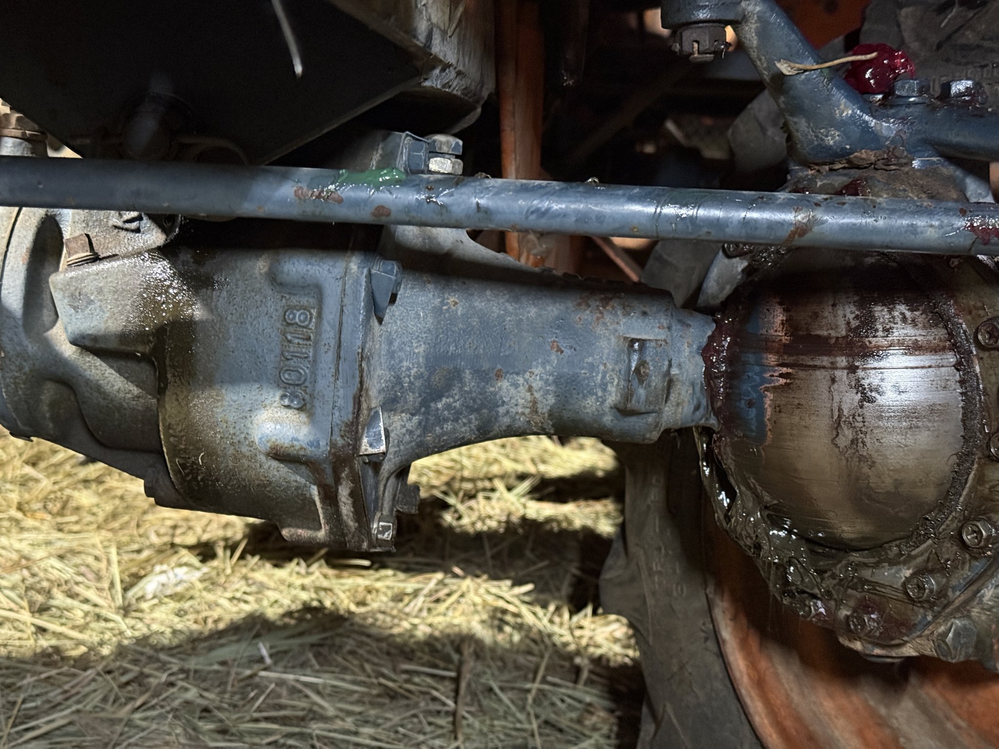

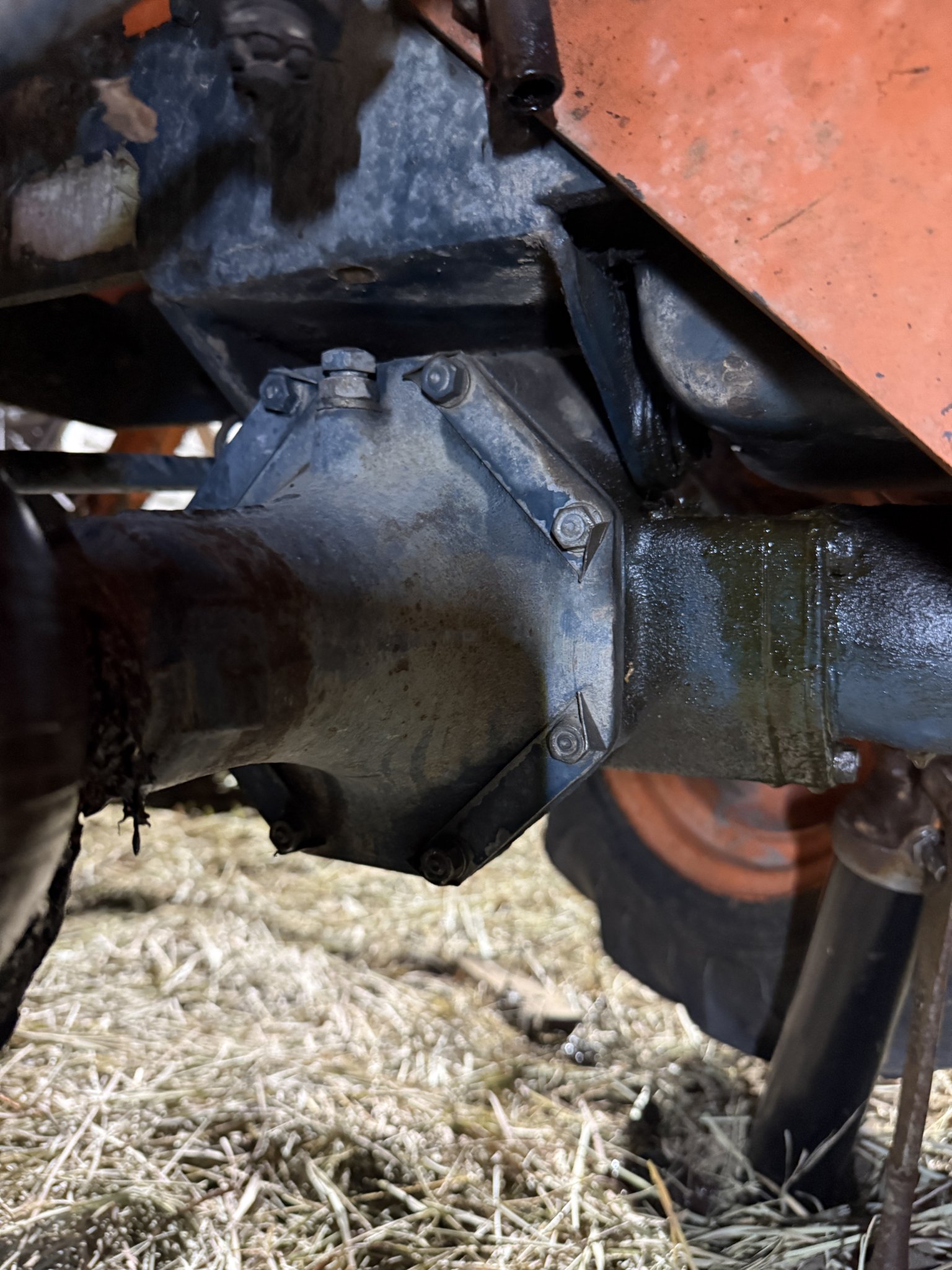

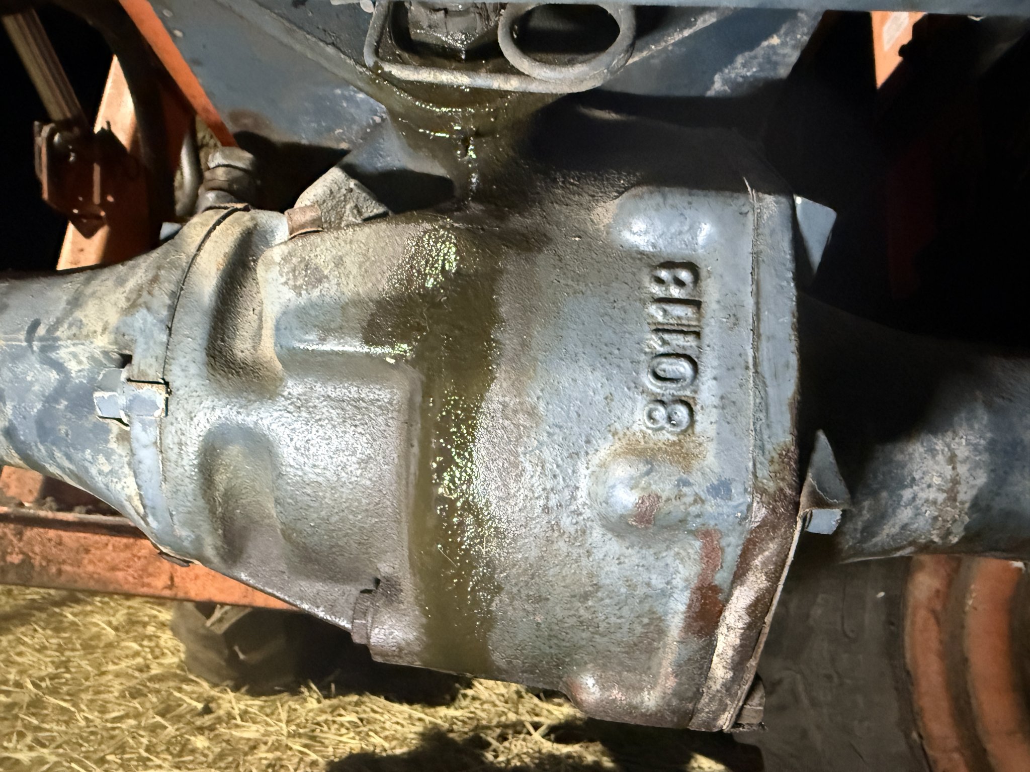

I have an early B7100-D with ball and socket type steer knuckles. The front axle is the only thing i havent been through and I decided to grease it after i got done using the tractor last night. It started purging old grease out of the knuckle so i decided to keep going until it came out clean grease. Then i saw a drip from the front differential area. At first i thought it had cracked the case but after looking closer it is pushing oil from the center pin somewhere. I hope that I didnt do any permanent damage. Did i screw up? Pictures are attached. It was cold and dark so hopefully they allow everyone to see whats is happening.

How much grease did you pump into it? :oops:
The front diff is supposed to be filled with Oil not grease.
You've managed to pump grease past the seals and into the housing.
My suggestion, pull it all apart and clean all the grease out of it, get new seals and check everything while your in there.

Thats what I thought. A good amount. I was pumping grease into the zerk on the steering arm knuckle and it was pushing some nasty old grease out from the dust seal. So i figured i would flush it out. Apparently out from the deal seal wasn't the only place it was being pushed. The front axle is the only thing i havent been through on the tractor. There was also what looked like rusty water coming out with the oil. Im wondering if there was some water in the front case.
