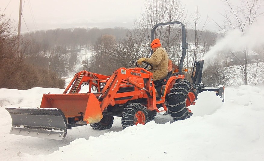

I have a B7610 with an FEL on the front and a 6’6” old manual angle snowplow on the 3 point. Vermont is lovely this time of year. It was -14 this morning. I religiously run the block heater below 10 for an hour….longer for colder temps. I’ll start it and let it run for a couple minutes with the PTO turning to “exercise” the hydraulic fluid.
She moves good and plows really well. The FEL, however, is slower than bloody death when I go to do some “snow bank management”.
It takes a solid 5-10 minutes til the stinking thing moves at a reasonable rate.
Has anyone installed a magnetic or silicone pad heater to pre-heat the hydraulic fluid so the bucket moves at a reasonable rate right from the start? I’m thinking to plug it in when I plug in the block heater.
