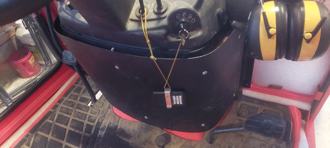

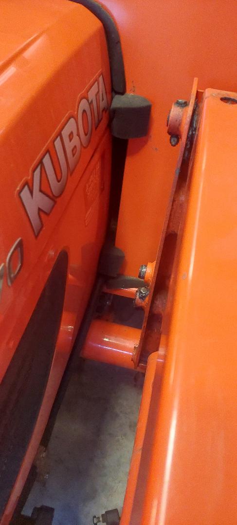

53woodsman,
Pictures of your setup would. When I built my cab for my BX, I allowed for air intake on both sides of the cowl cover. And, added a cover to provide airflow thru the original air intake screen located below the steering wheel. This cover attaches to the cab and provides about 3/4" space between the cover and intake screen providing cold air to the radiator. This setup has been working great since I built the cab several years ago. No overheating of the engine coolant and warm and toasty cab.
Let me know if you have any questions.

Very helpful, that's close to what I had in mind but I wondered if I was missing something and there was a factory solution I wasn't seeing. Kubota dropped the ball on this for sure. I'll get some photos posted. Thanks.
