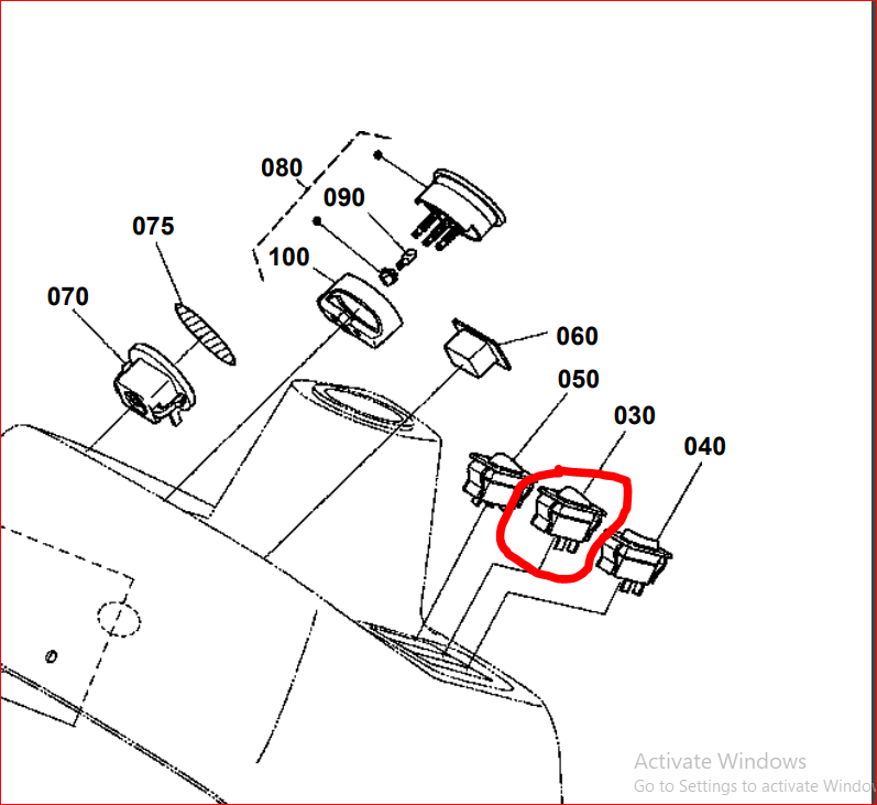

M mlan12 New member Equipment BX1500 Aug 13, 2022 11 1 3 Mossyrock, Washington Dec 27, 2023 #1 How is the headlight switch on a BX1500 removed?
85Hokie Moderator Staff member Lifetime Member Equipment BX-25D ,PTB. Under Armor, '90&'92-B7100HST's, '06 BX1850 FEL Jul 13, 2013 10,683 2,453 113 Bedford - VA Dec 27, 2023 #2 If you can get to the backside of the dash you can push on the tabs - if not a thin bladed screwdriver may allow it to pry out.
M mlan12 New member Equipment BX1500 Aug 13, 2022 11 1 3 Mossyrock, Washington Dec 27, 2023 #3 85Hokie said: If you can get to the backside of the dash you can push on the tabs - if not a thin bladed screwdriver may allow it to pry out. View attachment 118938 Click to expand... Thank you for your help.
J jaxs Well-known member Equipment B1750HST Jun 22, 2023 688 458 63 Texas Dec 30, 2023 #4 You might want to disconnect ground cable from battery before removing switch.
D DustyRusty Well-known member Equipment 2020 BX23S, BX2822 Snowblower, Curtis Deluxe Cab, Nov 8, 2015 6,132 4,710 113 North East CT Dec 30, 2023 #5 The switch you have circled usually can be pried up using a very thin screwdriver or a butter knife. That is how they also come out on my BX23S cab light switches.
